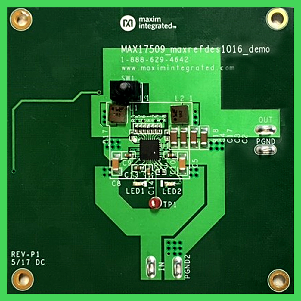

A dual-phase buck converter using MAX17509 is demonstrated for a 1.1V DC output application. The power supply delivers up to 6A at 1.1 V. Table 1 shows an overview of the design specification.
Designed, Built, Tested
This document describes the hardware shown in Figure 1. It provides a detailed systematic technical guide to design in a dual-phase buck converter using Maxim’s MAX17509 step-down DC-DC converter. The power supply has been built and tested, details of which follow later in this document.
