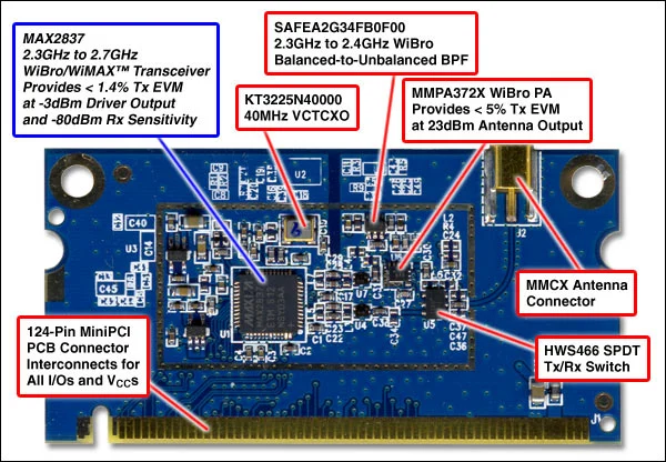

WiBro reference design built with the MAX2837
Figure 1. WiBro reference design built with the MAX2837 direct-conversion transceiver.
Figure 1. WiBro reference design built using the MAX2837 direct-conversion transceiver .
key design features
  • Complete RF to baseband WiBro solution
  • When the transmit power is +23dBm, the EVM is 5%, which meets the spectrum mask requirements.
  • When receiving sensitivity is -79dBm, EVM is 10%
  • 60dB transmit gain control range
  • 94dB receive gain control range
  • Optimized for low current mode
