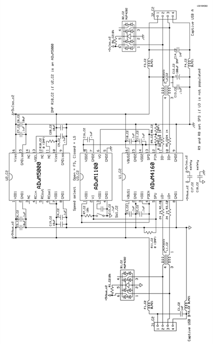

The goal of the application circuit shown in Figure 1 is to isolate a peripheral that has implemented a USB interface. Since no 100% efficient power converter can be used to transmit the bus voltage across the isolation, it is impossible to obtain a fully compliant bus-powered cable. Additionally, the converter's quiescent current does not meet the USB standard's standby current requirements, and the ADuM4160 has speed detection limitations. What is possible is a fixed-speed or switch-controlled speed cable that can deliver moderate power to downstream peripherals. However, this is a custom application and does not fully comply with the USB standard.

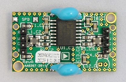

Figure 1. USB cable isolator circuit
Circuit description
The power used by the upstream USB connector is derived from the 5 V VBUS voltage provided by the USB cable. The bus voltage can also drive the ADuM5000 , which is used to generate the VBUS2 voltage for use by the downstream side of the ADuM4160 and provide up to 100 mA power to peripherals. The ADuM5000 was chosen for its high isolation voltage and small size. It can provide sufficient operating power for small bus-powered devices such as mice, keyboards and memory sticks. Because this device uses a chip-scale microtransformer and has a very high internal switching frequency, the design must use ferrite beads on the cable and follow the recommendations in application note AN-0971 to minimize the impact of electromagnetic radiation. In order for a system to pass EMI/RFI testing, special layout, decoupling, and grounding techniques must be used. For guidance, please refer to Tutorial MT-031 and Tutorial MT-101. For the complete layout and Gerber files for the ADuM4160 USB Cable Isolator, please visit: http://www.analog.com/CN0159-DesignSupport .

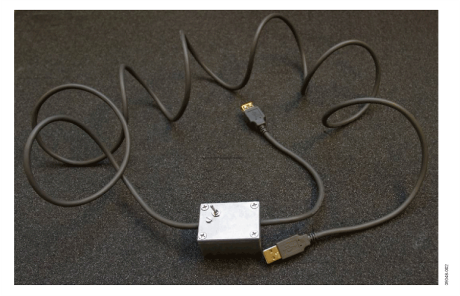

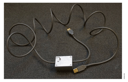

Figure 2. Isolated cable box
ADuM4160 isolated cable applications have multiple power supply, bus speed, and ESD/EOS protection options that must be determined. Peripherals operate at one of three speeds: low speed (1.5 Mbps), full speed (12 Mbps), and high speed (480 Mbps). The ADuM4160 does not support high-speed operation and blocks the handshake used to negotiate that speed. Overspeed mode starts with a full-speed configuration, and the peripheral requests high-speed support through a process called high-speed chirping. The ADuM4160 ignores this high-speed tuning; therefore, the high-speed operation request is never passed to the host and the peripheral automatically continues to run at full speed. This application circuit consists of a switch and a single channel isolator that allows the user to select the cable speed: full speed or low speed by setting the SPU and SPD pins. This feature is optional if single speed operation is sufficient.
The VBUSx pin provides power. The 3.3 V signal voltage is generated at the VDDx pin by an internal 3.3 V regulator. The ADuM4160 supports other power supply configurations, see other circuit notes for details. In the circuit shown in Figure 1, both the upstream and downstream sides of the ADuM4160 are set up to derive power from the VBUSx line and the internal regulator.
The ADuM4160 also offers an option to delay the application of an upstream pull-up resistor under peripheral control. This feature is controlled by PIN entry. In this application, the PIN input is shorted to high, so the upstream pull-up resistor is used whenever peripheral power is applied.
This circuit also uses protection devices. These devices are selected from manufacturers that offer a variety of different devices, and the specific device chosen allows them to be replaced with a 0 Ω short-circuit resistor to remove it from the circuit. Designers should carefully consider protection device selection, ranging from situations where no external protection is required to a full suite of transient suppressor and filter components. The components included in this application circuit show what type of protection can be used.

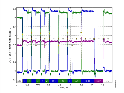

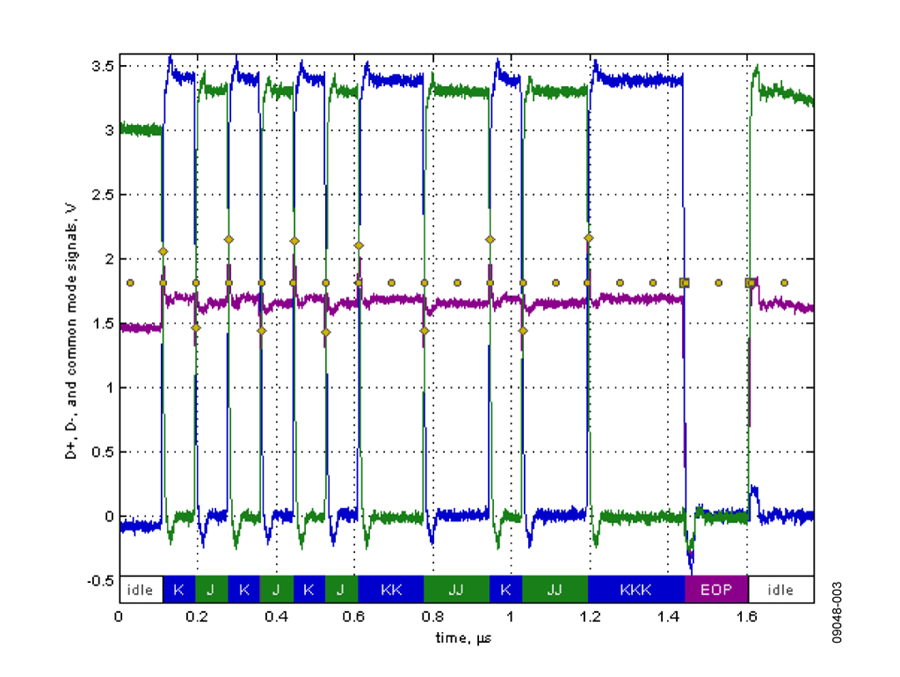

When the circuit is working, packet detection occurs and data is transferred from one side of the isolation to the other. Figures 3 and 4 and the data shown illustrate typical full-speed processing in the form of time domain data and eye diagrams respectively. In real-time data, characteristics to note are that the packet starts in the passive idle state, which transitions to the driven J state, and that the end of the packet at the end of processing shows a single-ended 0 state, followed by the idle J state. It is this automatic control flow and handling of these special logic states that enables the ADuM4160 chip and is unique on the market.

The data shown in Figure 3 and Figure 4 is generated during the USB-IF certification process. Figure 3 shows a test packet being transmitted from the ADuM4160 upstream port to the host. Note the pre-idle state, where the passive resistor network remains in the idle J state. The center of the pack is a mix of Jack and King. On the right side of the packet is the EOP (End of Packet) flag, which is a single-ended 0, followed by a driven J state, and then transitions to the idle J state.
Upstream full-speed signal quality test reference document—USB 2.0 specification Section 7.1.11, Section 7.1.2.1. Upstream full-speed rise time test reference document—USB 2.0 specification Section 7.1.11, Section 7.1.2.2. Upstream full-speed drop time test reference document—USB 2.0 specification section 7.1.11, section 7.1.2.2.
Figure 3 shows the full-speed eye diagram of the ADuM4160, which shows that it can provide a fully open eye diagram and stay away from the forbidden area. Similar data were obtained for the low-speed evaluation.
Figure 3. Full-speed test packet traffic driven by ADuM4160 upstream port
Figure 4. Full-speed eye diagram showing excluded regions
