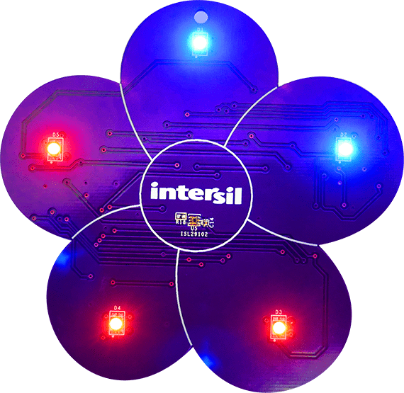

The Flower Power reference design highlights Renesas’ 4.5V – 18V input switching regulator. This board utilizes the ISL85005, 5A device as a representative of this full line-up of wide-input switching regulators. Additionally, the board uses the ISL29102 light-to-voltage sensor, the ISL21080 300nA NanoPower voltage reference, and the ISL28915 NanoPower, push/pull output comparator. The board is powered from two Energizer CR2032 3V coin cell batteries and thanks to its low-power design, will be able to deliver over 1,000 song cycles.
The Flower Power PCB is shaped like a 5-petal flower and comes in two colors, purple and yellow. It has five RGB LEDs on the front and an Renesas ambient light sensor to control the LED brightness. The flower features a Microchip MCU programmed to plays five songs while the LED lights flash in random patterns. Additionally, the reference design:
Displays a light pattern for low battery alert
Automatically enters power savings mode
Is powered with two CR2032 coin cell batteries; includes suction cup for hanging
When start button is pressed, LEDs flash in a pattern to the melody of the five hippie-era songs: “Do You Believe in Magic,” “Are you Going to San Francisco,” “Here Comes the Sun,” “Age of Aquarius/Let the Sun Shine In,” and “Puff the Magic Dragon”
