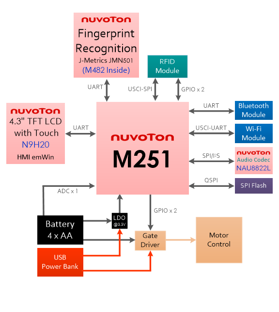

Four-in-one smart electronic lock
It uses a low-power microcontroller to extend the product's operating time to 12 months. It is equipped with a fingerprint module, RFID module, Bluetooth module, Wi-Fi module, touch screen and audio codec to achieve password, fingerprint, card and App Intelligent electronic lock with remote door opening function and graphical touch human-machine interface.
  • Program features
    Low-power microcontroller extends product operation time to 12 months
    - Floating security code and virtual password function
    - Maximum record of 100 fingerprints
    - Supports 20 sets of RFID cards
    - Remote temporary password and App Bluetooth to open the door
    - emWin graphical human-machine interface
    - With opening, closing and alarm sounds
  • MCU Features
    - M251 / M252 (32-bit Arm® Cortex®-M23)
    - With Deep Power-down mode, power consumption is less than 1.3 microamps, extending product running time
    - Rich communication peripherals to connect various external expansion modules
    - Supports XOM (eXecute-Only-Memory), hardware AES encryption and decryption, and Tamper pins to improve product security
    Supports high-precision ADC and OPA functions to achieve precise voltage measurement
Blockdiagram
