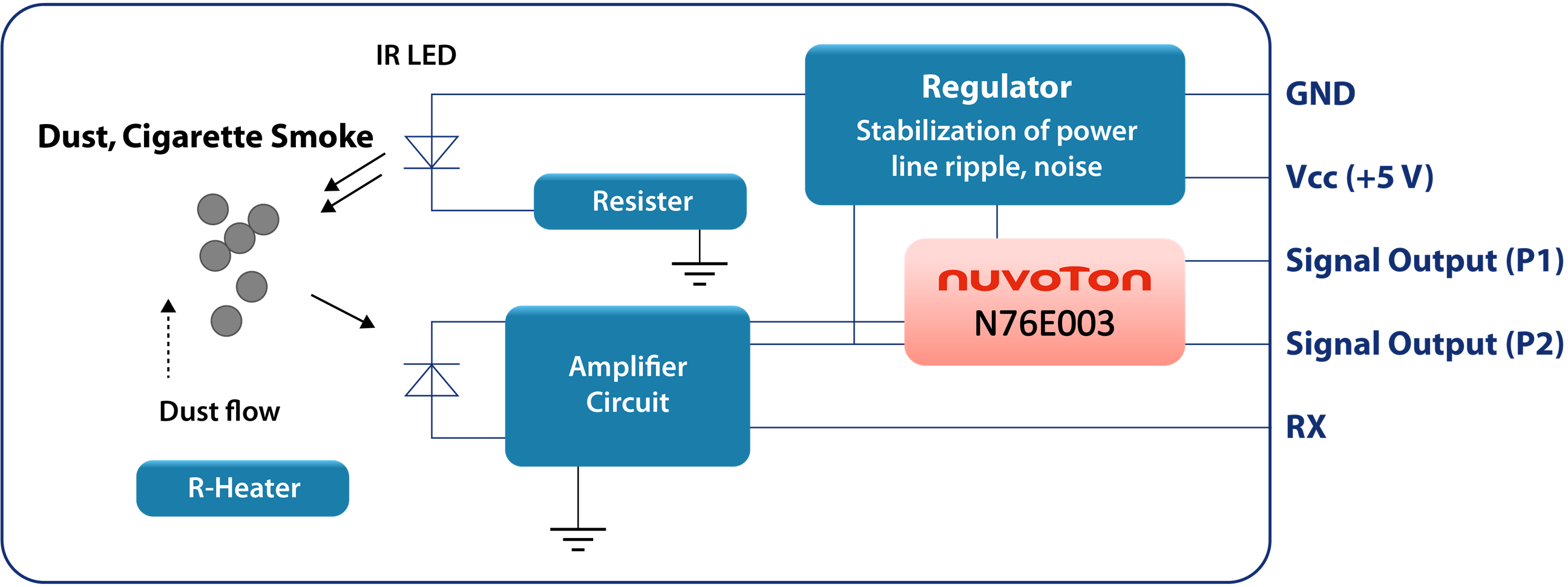

PM2.5 infrared module: the main control adopts  N76E003  microcontroller (1T enhanced 8051 18 KB Flash, built-in 12-bit ADC)
    • Infrared turbidity detection method: The light source is an infrared LED. The air inlet and outlet mainly rely on resistance heating to obtain hot air flow. When particles pass through, a high level is output, and the output signal is mostly PWM. Particles >1um indicate preliminary grade and are suitable for industrial and mining dust detection.
    • Main control microcontroller: N76E003
      • 1T enhanced 8051 Flash
      • 18 KB Flash ROM, 1 KB Data RAM
      • Built-in 12-bit ADC
      • Wide voltage operating range: 2.4V ~ 5.5V, industrial-grade operating temperature: -40 ~ 105 °C
      • Built-in high-precision RC oscillator 16MHz, ±1% error at normal temperature; ±2% error at full temperature and full voltage
      • Excellent ESD & EFT immunity: EFT / 4.4 kV & ESD / HBM, up to 7 kV
      • Package: TSSOP20/QFN20 (3mm x 3mm)

Blockdiagram
