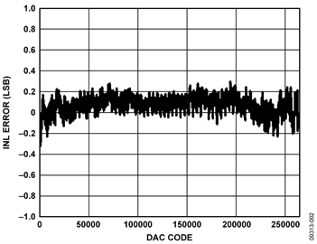

The precision performance of the circuit shown in Figure 1 is illustrated by the data in Figures 2 and 3, which show integral and differential nonlinearity as a function of DAC code. It is evident from the figure that these two characteristics are within the specifications of ±0.5 LSB and ±0.5 LSB respectively.
The total unregulated error of this circuit is composed of various DC errors, namely INL error, offset error, and gain error. Figure 4 shows a plot of total unadjusted error versus DAC code. The error is maximum when the DAC code is 0 and 262,143. This is expected and is caused by the absolute error in the reference output, the mismatch in the external resistors R2 and R3 (see Figure 1), and the mismatch in the AD5781 internal resistors RFB and R1 (see Figure 5).
The absolute error of the reference voltage is rated at 0.04%; the mismatch between resistors R2 and R3 in this example is rated at 0.02%; the mismatch between internal resistors R1 and RFB is rated at 0.01%. Therefore, the total gain error is 0.07% of full-scale range, or 184 LSB. Figure 4 shows a measured value of 20 LSB (i.e., 0.007% of full-scale range), indicating that all devices performed significantly better than their rated tolerances.
