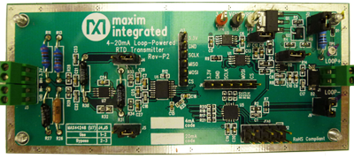

The Monterey design is based on a complete Maxim solution and combines ultra-low power consumption with high accuracy and precision.
  1. MAX44248 low-noise, zero-drift op amp
  2. MAX11200 High-Accuracy, Low-Power, 24-Bit Delta-Sigma  ADC
  3. MAXQ615 low-power microcontroller
  4. MAX5216 low-noise, high-precision, low-power 16-bit DAC
  5. MAX9620 low-power operational amplifier
  6. MAX15007 wide input voltage range, low power LDO
Loop-powered sensor transmitters are targeted at industrial sensors, industrial automation, and process control, but can be used in any application that requires high-precision conversion.
Simplicity, reliability, good noise immunity, long range, and low cost make the Monterey (MAXREFDES15#) ( Figure 1 ) interface ideal for industrial process control and remote object automation.

  • C connect the industry standard power supply to the LOOP+ and LOOP- ends of J1 to power the circuit board.
  • Connect the sensor to J3. The current design configuration of the board is for a 2-wire RTD application. With minor modifications to the sensor side, it can be used in 3/4-wire RTD applications.
