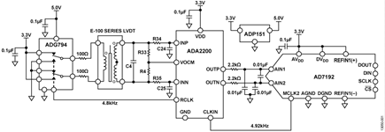

The circuit shown in Figure 1 is a complete linear variable differential transformer (LVDT) signal conditioning circuit that accurately measures linear position or linear displacement from a mechanical reference point. Synchronous demodulation in the analog domain is used to extract position information and suppress external noise. A 24-bit, sigma-delta analog-to-digital converter (ADC) digitizes position output information for high accuracy.

Figure 1. LVDT signal conditioning circuit (schematic: all connections and decoupling not shown)

The ADA2200 synchronous demodulator extracts position information by filtering the LVDT secondary signal before demodulating the signal to a low-frequency output voltage proportional to the LVDT core displacement. The ADA2200 drives the AD7192 24-bit Σ-Δ ADC, which digitizes and filters the output. The ADA2200 generates a synchronous LVDT excitation signal, and the ADG794 switch converts the CMOS level excitation signal into a precision 3.3 V square wave signal that drives the LVDT primary winding.
LVDT is an absolute displacement sensor that converts linear displacement into a proportional electrical signal. LVDTs are special wire-wound transformers with a movable core positioned to fit the location under test. The excitation signal is applied to the primary winding. As the core moves, the voltage on the secondary winding changes proportionally; from this voltage the position can be calculated.
There are many types of LVDTs, and the methods for extracting location information also vary. The circuit in Figure 1 uses a 4-wire mode LVDT. Subtraction is performed by connecting the secondary outputs of two LVDTs so that their voltages are opposite. When the LVDT core is at the zero position, the voltages on the two secondary terminals are equal and the voltage difference on the two windings is zero. As the core moves from the zero position, the voltage difference across the secondary winding increases. The LVDT output voltage phase changes depending on the direction.
The main clock of this circuit is generated by AD7192ADC. The ADA2200 accepts the master clock and generates all clocks within it, including the reference clock used as the LV DT excitation signal. The clock divider on the ADA2200 is configured to generate a 4.8 kHz excitation signal. The ADG794 converts the excitation signal into a precision ±3.3 V square wave signal. The +3.3 V is derived from the ADC supply voltage. The 3.3 V supply is also used as the ADC reference voltage; therefore, the ratio between the excitation signal and the ADC reference voltage can improve the noise performance and stability of the circuit. The system's 3.3 V supply is provided by the ADP151 low dropout regulator; the latter is driven from the 5 V supply.
The coupling circuit between the LVDT secondary winding and the ADA2200 input is used to limit the signal bandwidth and adjust the relative phase between RCLK and the ADA2200 input. The circuit is configured to have a maximum quadrature (phase = 90°) response and a minimum in-phase (phase = 0°) response. This allows the position to be determined just by measuring the quadrature output, making the ADA2200 output voltage less sensitive to changes in phase in the circuit. Temperature changes in the LVDT cause changes in the effective series resistance and inductance and are the main source of phase changes.
Anti-aliasing filters at the ADA2200 output maintain the signal bandwidth supported by the ADC. The output bandwidth of the AD7192's internal digital filter is approximately 0.27 times the output data rate. To maintain the output bandwidth at the 4.8 kHz maximum output data rate, the −3 dB corner frequency of the output antialiasing filter can be set to approximately 2 kHz. For systems requiring lower output data rates, the corner frequency of the antialiasing filter can be reduced accordingly.

The ADA2200 integrated synchronous demodulator forms the core of the circuit. It uses unique charge sharing technology to perform discrete-time signal processing within the analog domain. The ADA2200 has a fully differential signal path. It consists of a high-impedance input buffer followed by a fixed low-pass filter (FIR decimation filter), a programmable IIR filter, a demodulator and a differential output buffer. Its input and output common-mode voltage is equal to 1.65 V (½ of the 3.3 V supply voltage).
The ADA2200 accepts the 4.92 MHz clock signal from the AD7192ADC and then generates all of its internal clocks, as well as the 4.8 kHz reference clock used as the LVDT excitation signal. The ADA2200 integrates a configurable clock divider that is programmable to support many different excitation frequencies.
CMOS switch
The ADG794 CMOS switch was chosen because of its low on-resistance, fast switching time, break-before-make switching action, and low cost.
The ADG794 converts the ADA2200's low-voltage CMOS level RCLK output into a low-impedance differential output square wave source that then drives an LVDT. To allow headroom for the switches to drive positive 3.3 V signals, the ADG794VDD input is powered from a 5 V supply.

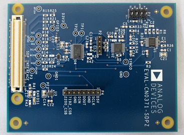

The circuit in Figure 1 can support a variety of LVDTs with only minor modifications. MeasurementSpecialties, Inc. E-100 LVDT is used in four-wire mode to demonstrate the main features of the circuit. The E-100 has a stroke range of ±2.54 mm, an output sensitivity of 240 mV/V at the stroke end, a maximum linearity error of ±0.5% in the full-scale range, and an operating frequency range of 100 Hz to 10 kHz. See the E-Series LVDT data sheet for complete details.
ADA2200 input coupling network
The ADA2200 input coupling network can be tuned to support different LVDTs. The LVDT secondary winding inductor and shunt capacitor (C4) form an oscillation circuit. The R4 and R33 resistors reduce the Q value of the oscillation circuit, making the circuit less susceptible to changes in the LVDT winding inductance and resistance, but the power consumption increases. The RC filter pair of R34/C24 and R35/C25 reduces the signal bandwidth while providing the additional degree of freedom needed to adjust the relative phase of the circuit. The maximum output of the ADA2200's internal phase-sensitive detector (PSD) occurs at 0° or 180° relative phase shift.

For complete circuit documentation including schematics, layout and bill of materials, see www.analog.com/CN0371-DesignSupport .
