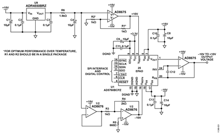

The circuit shown in Figure 1 is a 16-bit, ultra-stable, low-noise, precision, bipolar, ±10 V voltage source requiring only a minimum number of precision external components.
The AD5760 voltage output DAC (Grade B) has a maximum integral nonlinearity (INL) of ±0.5 LSB and a maximum differential nonlinearity (DNL) of ±0.5 LSB.
The complete system has less than 0.1 LSB peak-to-peak noise and drift, measured at 100-second intervals. This circuit is suitable for use in medical instrumentation, test and measurement, and industrial control applications requiring precision low-drift voltage sources.
The circuit shown in Figure 1 is based on the AD5760 true 16-bit, unbuffered voltage output DAC operating from bipolar supplies up to 33 V. The positive reference voltage input range of the AD5760 is 5 V to VDD − 2.5 V, and the negative reference voltage input range is VSS + 2.5 V to 0 V. The maximum relative accuracy is ±0.5 LSB, ensuring operating monotonicity and differential nonlinearity (DNL). Maximum value is ±0.5 LSB. The AD5760 output noise is 8 nV/√Hz and has extremely high long-term linear error stability (0.00625 LSB).
Figure 1 shows the AD5760 configured in unity gain mode with amplifier input bias current compensation, producing a symmetrical bipolar output voltage range. This mode of operation uses an external output op amp and on-chip resistors (see the AD5760 data sheet) to provide input bias current compensation. These internal resistors are thermally matched to each other and to the DAC ladder, allowing ratiometric thermal tracking.
The AD8675 precision op amp has low offset voltage (75 μV maximum) and low noise (typ. 2.8 nV/√Hz, 0.1 μV pp, 0.1 Hz to 10 Hz), making it an optimal output buffer for the AD5760. The AD5760 has two internally matched 6.8 kΩ feedforward and feedback resistors that can either be connected to the AD8675 op amp to provide a 10 V offset voltage, thereby enabling a ±10 V output swing, or they can be connected in parallel to provide bias current cancellation. . This example shows a ±10 V bipolar output with resistors used for the bias current cancellation function. The internal resistor connection is controlled by setting the relevant bits in the AD5760 control register (see AD5760 data sheet).
The ADR4550 is a high-precision voltage reference that provides excellent temperature stability (2 ppm/°C maximum, Grade B) and ultra-low output voltage noise (2.8 μV pp, 0.1 Hz to 10 Hz). These characteristics make it an ideal reference voltage source for the AD5760.
To obtain a ±10 V output voltage range, the ADR4550's +5 V reference voltage is amplified to ±10 V using the AD8675 and AD8676 (dual AD8675) (shown in Figure 1).
The output buffer also uses the AD8675, which has low noise and low drift characteristics. This amplifier works with the AD8676, a dual-channel version of the AD8675, to amplify the low-noise ADR4550's +5 V reference to +10 V and -10 V, respectively. R1, R2, R3, and R4 in this gain circuit are precision metal sheet resistors with tolerance and temperature coefficient resistors of 0.01% and 0.6 ppm/°C respectively. R6 and C4 form a low-pass filter with a cutoff frequency of approximately 10 Hz. This filter is used to attenuate reference noise.
If desired, a single dual-channel amplifier AD8676 can be used in place of the two AD8675 op amps in the circuit. However, the EVAL-AD5760SDZ board is designed to provide output stage flexibility, so two AD8675 op amps were chosen for this example.
The circuit's digital inputs are serial inputs and are compatible with standard SPI, QSPI, MICROWIRE® and DSP interface standards.

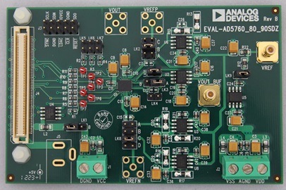

The precision performance of the circuit shown in Figure 1 is demonstrated on the EVAL-AD5760 evaluation board using an Agilent 3458A multimeter. Figure 2 shows that the integral nonlinearity is a function of DAC code and is within the ±0.5 LSB specification.
Figure 3 shows differential nonlinearity as a function of DAC code and is within the ±0.5LSB specification.
