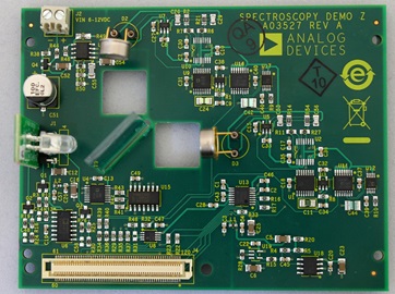

The circuit shown in Figure 1 is a dual-channel colorimeter integrating a modulated light source transmitter and a synchronous detector receiver. The circuit measures the ratio of light absorbed by the sample to the reference container at three different wavelengths.
This circuit provides an efficient solution for many chemical analysis and environmental monitoring instrumentation used to measure concentration and characterize materials through absorption spectroscopy.

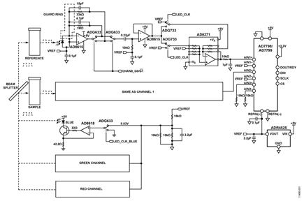

Figure 1. Two-channel colorimeter with programmable gain transimpedance amplifier and lock-in amplifier (schematic diagram: all connections and decoupling not shown)
Circuit description
The AD8618 quad op amp forms three simple current sources to drive LEDs with constant current. The EVAL-SDP-CB1Z generates a 5 kHz clock that modulates an LED through the ADG633 single-pole double-throw (SPDT) switch to turn the reference voltage of its current source on or off. Setting the current sources of the other two LEDs to 0 V turns them off when not in use.
The beam splitter sends half of the light through the sample container and the other half through the reference container. Depending on the type and concentration of the medium in each container, the containers can absorb different amounts of light. A photodiode on the other side of each container generates a small amount of current, proportional to the amount of light received.

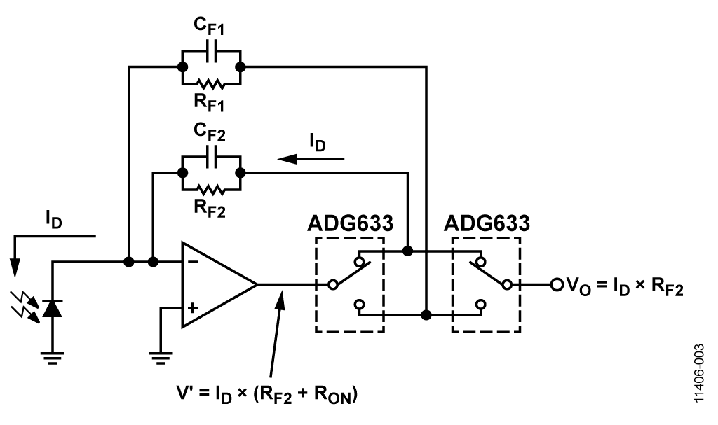

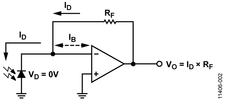

Figure 2 shows a typical transconductance amplifier with a single feedback resistor and its ideal transfer function.
Figure 2. Transconductance Amplifier Transfer Function
Because some of the solutions being tested may have very strong absorptive properties, it is sometimes necessary to use a large feedback resistor in order to measure the very small currents produced by the photodiode, while at the same time being able to measure the large currents corresponding to highly dilute solutions. To solve this problem, the photodiode amplifier in Figure 1 contains two different selectable gains. One gain is set to 33 kΩ and the other is set to 1 MΩ. When a single SPDT switch is connected to the output of the op amp to switch the feedback resistor, the on-resistance of the ADG633 can cause a transimpedance gain error
To avoid this problem, Figure 3 shows a better configuration in which the ADG633 inside the feedback loop selects the desired resistor, while a second switch connects the next stage of the system to the selected feedback loop. The voltage at the amplifier output is:
V TIA OUTPUT = I PHOTODIODE × R FEEDBACK
rather than
V TIA OUTPUT = I PHOTODIODE × (R FEEDBACK + R ONADG633 )
It represents gain error. However, because one of the ADG633s is outside the feedback loop, the output impedance of this stage is the on-resistance of the ADG633 (typically 52 Ω) rather than the very low output impedance associated with the op amp output when operating in a closed loop.
Note that feedback capacitor C Fx is required for stability reasons to compensate for the total input capacitance (diode capacitance plus op amp input capacitance) as well as the pole created by feedback resistor R Fx . For details on this analysis, see Part 5 in Practical Design Tips for Sensor Signal Conditioning .
Even the best rail-to-rail output amplifiers such as the AD8615 cannot fully swing the output to the rails. Additionally, the input offset voltage on the AD8615 can be negative, albeit very small. The ADR4525 voltage reference biases the photodiode and amplifier to 2.5 V instead of using a negative supply to ensure that the amplifier does not clip and can therefore be driven to 0 V. The analog and digital portions of the board are powered with a 5 V linear regulator.
Figure 3. Programmable gain transconductance amplifier
The photodiode amplifier output voltage can swing from 2.5 V to 5.0 V. For the 33 kΩ range, a 2.5 V output range corresponds to a full-scale photodiode current of 75.8 μA. For a 1 MΩ range this corresponds to 2.5 μA. When operating with a gain setting of 1 MΩ, it is important to protect the photodiode from outside light to prevent amplifier saturation. While the synchronous rectifier described below can greatly attenuate any frequency that is not synchronized with the LED clock, it will not function properly if the upper stage is attenuated. Gain settings for each channel are independently selectable via the EVAL-SDP-CB1Z board.

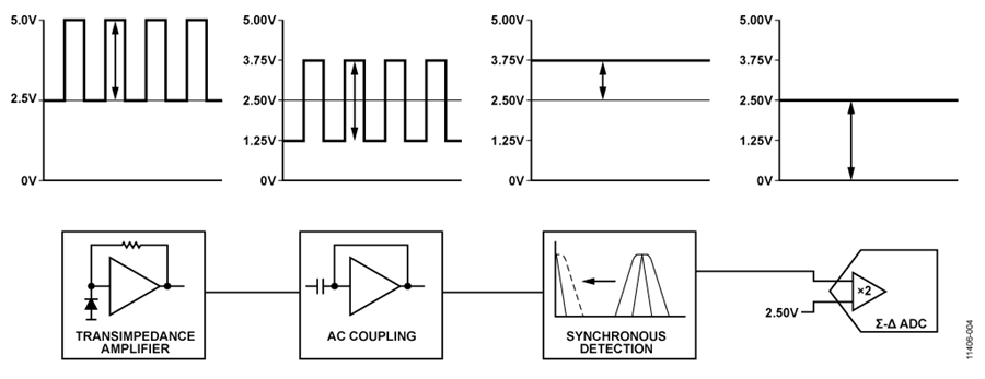

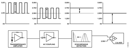

Figure 4. System block diagram and time domain waveforms for each step
Figure 4 is a system block diagram with the voltage range of each stage marked. The result after processing by the synchronous rectifier circuit is a variable DC voltage ranging from 2.5 V (no light reaches the photodiode) to 3.75 V (full-scale light input). This output voltage corresponds to a full-scale output swing of 1.25 V.
This circuit filters signals whose frequency is not synchronized with the LED clock (or odd harmonics, since the clock waveform is a square wave). In the frequency domain, the low-pass filter at the AD8271 output looks like a band-pass filter around the LED clock frequency. The lower the bandwidth of this filter, the better the synchronous rectifier suppresses out-of-band noise. Due to noise rejection and settling time trade-offs, the cutoff frequency of this filter is set to 16 Hz. It must be noted that the bandwidth of this filter is approximately equal to the LED clock. For example, if the LED modulation is 5 kHz, the 3 dB passband range of the synchronous detector is 4.984 kHz to 5.016 kHz.

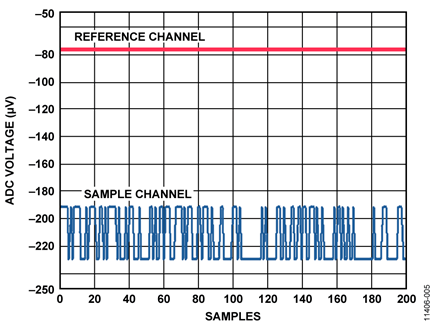

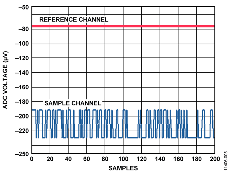

To verify that the front-end circuitry does not generate excessive noise on the system, data was collected with the LED disabled. The synchronous detector still operates at the LED clock frequency, but will not detect any light signal synchronized with this clock. Therefore, it removes all DC and AC signals except the errors generated by the AD8271 and ADC. Figure 5 shows the noise in this configuration, which is less than 1 LSB peak-to-peak for a single channel (ADC input centered between two codes) and 1 LSB peak-to-peak for the other channel (ADC input centered between two adjacent codes). in the transition area). Also, note that the measured voltage is negative, on the order of a few mV, which is expected performance in line with the typical offset error distribution of the AD8271.
Figure 5. ADC voltage with LED source disabled
