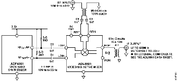

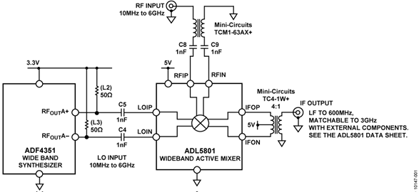

Figure 1. Broadband interface between the ADF4351 PLL (integrated VCO) and the ADL5801 wideband active mixer (simplified schematic showing only interface details)

The ADF4351 PLL has a differential LO output interface, and the ADL5801 is optimized for differential LO driving. The differential interface provides common-mode noise rejection and even-order harmonic cancellation.

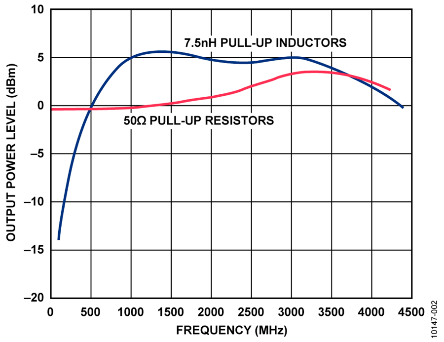

Under normal circumstances, it is recommended to use a pull-up bias inductor at the output port of the ADF4351. This solution outputs higher power but limits the frequency range of the device. The standard evaluation board is equipped with two 7.5 nH pull-up inductors for optimal performance above 500 MHz. In the circuit shown in Figure 1, the bias inductor is replaced by two 50 Ω pull-up resistors to reduce the frequency dependence of the output interface. This change results in a reduction in output power; however, the ADL5801 can tolerate this limitation because the device is rated for a LO drive level as low as −10 dBm. Figure 2 compares the output power of the device under two pull-up network conditions: resistive and inductive.
Figure 2. Comparison of power levels at the ADF4351 output with resistive and inductive pull-up networks.
The resistive pull-up network represents a nominal differential impedance of 100 Ω at the output, while the differential input impedance of the ADL5801LO port is 50 Ω. Impedance mismatch in the mixer LO path does not degrade circuit performance. However, it is recommended to keep the length of the connecting traces between devices as short as possible to reduce the impact of impedance mismatch.

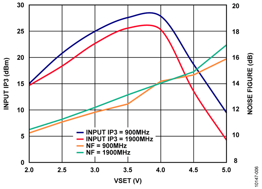

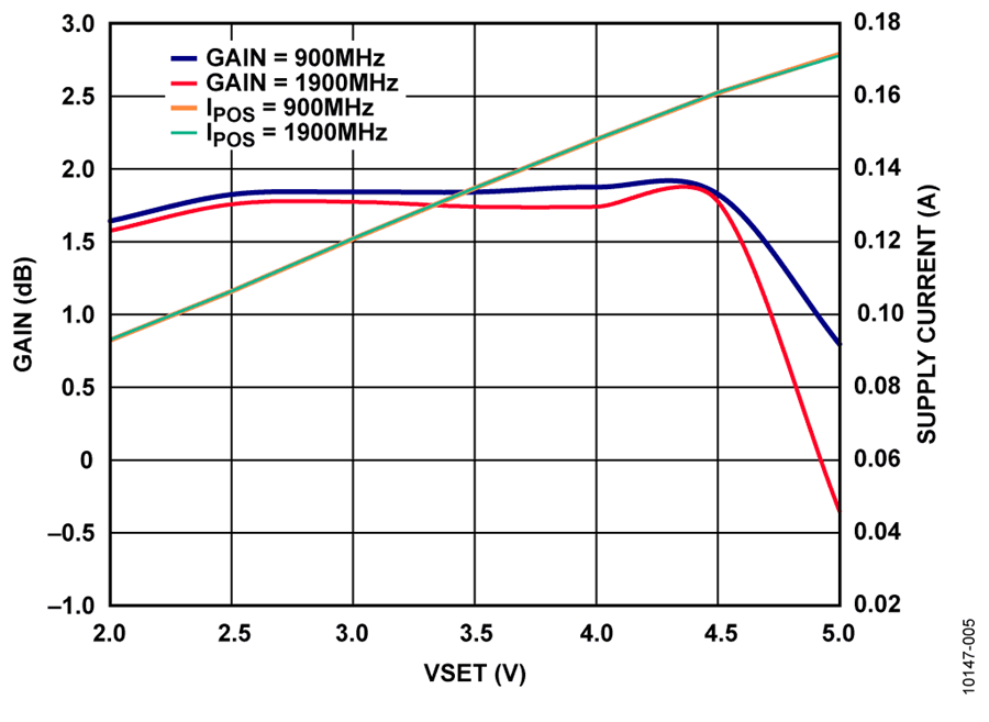

The ADF4351 activates several parts of its divider network to produce an output frequency that spans multiple octaves. The power consumption of the circuit depends on the operating frequency and the bias point of the mixer. The combination of these parts determines the power consumption of the PLL. For example, when the PLL is programmed to output a frequency of 35 MHz, the device activates all 6 divider networks and consumes 132 mA. This point represents the worst-case power consumption point of the device. Similarly, the ADL5801's bias level, which can be used to adjust IP3 and noise figure, determines the mixer's power consumption. The VSET pin is used to adjust the bias level of the device. Figures 5 and 6 show the mixer’s DC current, input IP3, and noise figure performance as a function of VSET voltage.
Figure 5. Power conversion gain and supply current versus VSET
Figure 6. Input IP3 and Noise Figure vs. VSET
The VSET level is directly proportional to the DC operating current and input IP3, while the noise figure is inversely proportional to the VSET voltage. The mixer exhibits optimal linearity when the VSET voltage is 3.6 V. When the mixer bias level is 3.6 V and the PLL is at its worst-case power point (all dividers on), the circuit consumes approximately 1.14 W.
