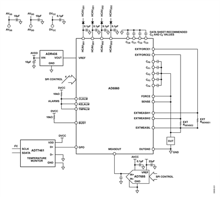

The AD5560 DPS provides the supply voltages and measurement capabilities required by the device under test, but to complete the circuit, several additional components are required: a voltage reference; an ADC to digitize the measurements; and a temperature monitor , used to measure the temperature of the internal detection diode so that the user can view the temperature gradient on the chip or PC board.
The ADC is used to digitize the measurement output. Depending on the reference voltage and OFFSET DAC settings, the measurement output (MEASOUT pin) can provide different output ranges.
Using the OFFSET DAC, the forced voltage output range can be offset to achieve different output ranges. The specific output range that this article focuses on is 0 V to 25 V. Therefore, the default MEASOUT output range (MEASOUT GAIN = 1) will also be 0 V to 25 V. No ADC can handle this output range directly, so some external signal conditioning is required to match the range to the input range of a unipolar or bipolar ADC.
MEASOUT also has a setting (MEASOUT GAIN = 0.2) that adjusts the MEASOUT output range to offset 0 V to 5.125 V. (It is slightly over-range and can be used for calibration, etc.)

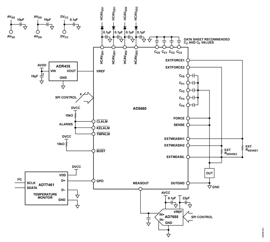

Figure 1. Device power supply (DPS) suitable for automated test equipment (schematic, decoupling and all connections not shown)
For this example, we will use the 0 V to 5.125 V range so that we can easily use a unipolar input ADC.
The AD7685, 16-bit, 250 kSPS ADC is capable of handling the 0 V to 5 V output range on the MEASOUT path, making it suitable for this application. Additionally, if an upgrade path is desired, other faster ADCs of the same size, such as the 500 kSPS AD7686 , are also attractive options.

reference voltage source
Since a 25 V output voltage range is required, the 5 V X-FET reference ADR435 was selected . This reference has excellent temperature drift performance and low noise, and is capable of driving multiple PMU channels.
temperature monitor
The AD5560 has an array of 16 temperature monitoring diodes located at different points on the chip. These diodes must be driven with current to produce a voltage that indicates the temperature of the corresponding area of ​​the chip. With so many temperature diodes on a chip, users can measure the temperature gradient of the chip or board under specific conditions. For this purpose, ON Semiconductor's temperature monitor ADT7461A was selected to interface with the on-chip temperature diode. Since each diode in this example is connected to the GPO pin of the AD5560 through a multiplexer, the series resistance cancellation feature of the ADT7461A is important. Without series resistance cancellation, the multiplexer's on-resistance would create measurement errors. Please note that the ADT7461A has a two-wire interface.

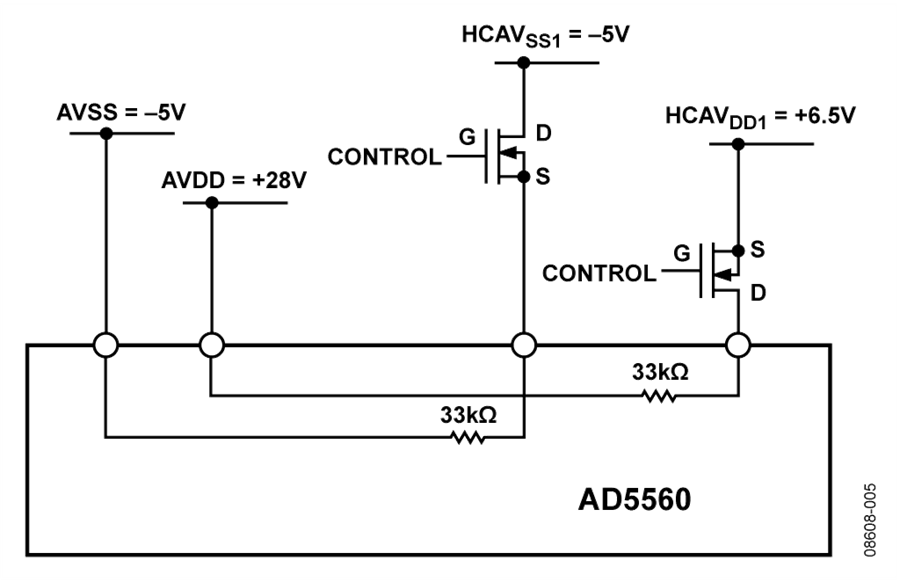

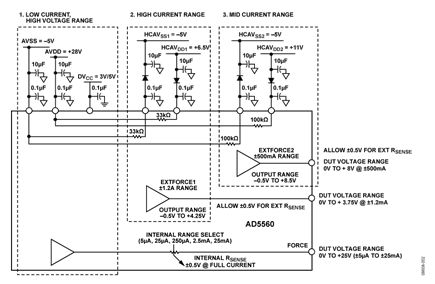

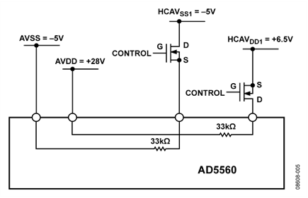

Figure 2. An example of using additional supply rails within the AD5560 to achieve multiple voltage/current ranges and minimize power dissipation (schematic diagram, decoupling and all connections not shown)
The voltage range of the C CX and C FX pins is the same as the expected voltage range on FORCE; therefore, this should be considered when selecting capacitors. The C FX capacitor can have a 10% tolerance, especially when measuring current in the low current range, and this additional variable directly affects settling time. The tolerance of C CX should not be greater than 5%.
Output voltage range
The output voltage range of this design circuit is as follows:
0 V to 25 V / 5 μA to 25 mA
0 V to 7 V / 500 mA
0 V to 3 V / 1.2 A
To configure these rail combinations, we need to adjust the OFFSET DAC settings. The recommended value is 0xD1D, which achieves the above range. The example shown in Figure 2 illustrates how to assign the AD5560 to achieve these output ranges.

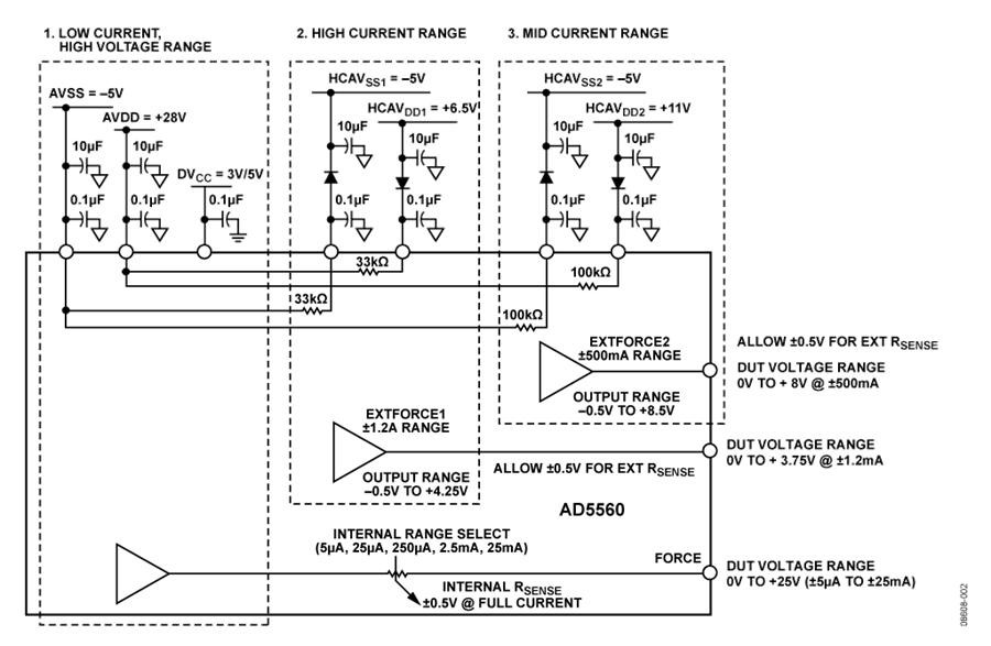

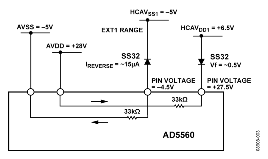

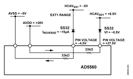

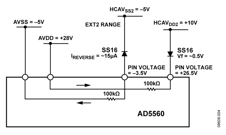

High Current (HC) Power Path Diodes
Because the AD5560 can source high current, providing current ranges up to 1.2 A, these supply rails can be divided into three different types: the low current range (5 μA to 25 mA) is powered by AVDD/AVSS; the middle current range (called EXT2) is powered by HCAVDD2/HCAVSS2; the high current range (called EXT1) is powered by HCAVDD1/HCAVSS1. The HC supply should always be equal to or less than the AVDD/AVSS supply rails. The purpose of the HC power rail is to allow the user to select a lower voltage power supply to reduce the power consumption of the AD5560. The EXT1 and EXT2 output stage designs require a supply voltage higher than the voltage of the device under test. If the HC power supply is lower than the AVDD/AVSS power supply, the above requirements may not be met. Therefore, we recommend adding a diode in the path between the HC power supply and the HC package pins (as shown in Figure 2). When the EXT1 or EXT2 stage turns off, we want it to stay off and not leak current into the device under test. This diode, along with the internal leakage resistor, will increase the HC package pin voltage (close to the AVDD/AVSS supply rails), allowing the EXT1/EXT2 output stages to remain off. Figures 3 and 4 show diode circuit details suitable for the EXT1 and EXT2 ranges respectively.
Figure 3. Example of diode for EXT1 range
The diode needs to be able to carry the highest current that the output stage can deliver (including transient current/fault conditions). The current requirements of the EXT1 stage are likely to be much higher than the EXT2 stage, so when choosing diodes it is best to choose different diodes for EXT1 and EXT2 respectively (in terms of board size).
To minimize total power consumption and power overhead, the voltage drop should be as low as possible.

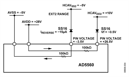

The leakage current or reverse current when the diode is turned off should be low enough to ensure that the HC pin voltage can support the output voltage range of the device under test. The reverse current of the diode creates a voltage drop across the internal leakage resistors (33 kΩ for EXT1 and 100 kΩ for EXT2); therefore, the HC pin voltage decreases.
Suitable diodes are available from many suppliers, such as ON Semiconductor, Vishay, etc.
The diode can be replaced with a low on-resistance power MOSFET, as shown in Figure 5. Since the voltage drop across the FET is much lower than that of the diode, the advantage of using a MOSFET is that it can reduce total power consumption.
Please note that there is a parasitic body diode between the drain and source of discrete power MOS devices. The orientation of this diode must be the same as that of the commonly used diode that the MOS device replaces. At the same time, a suitable driver must be provided for the MOS gate.
Figure 4. Example of diode for EXT2 range
Figure 5. Example of using MOSFETs instead of diodes

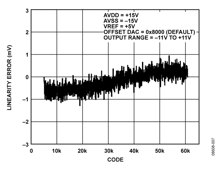

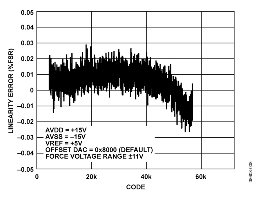

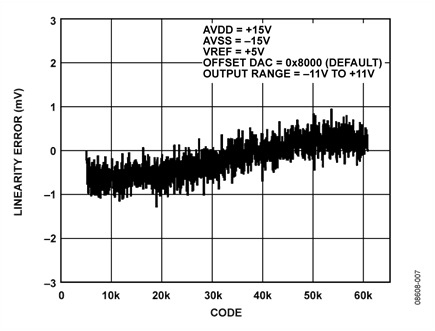

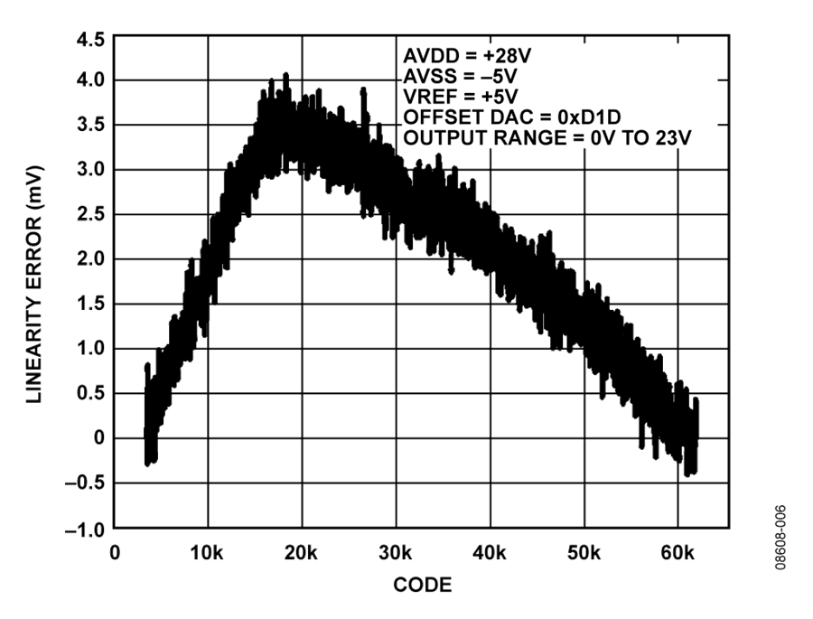

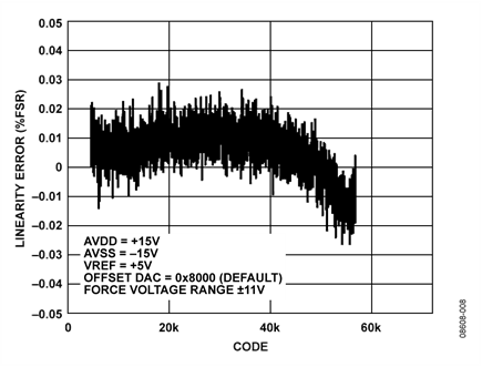

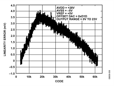

Linearity measurement
Figures 6 and 7 show the linearity measurement results of the system in FVMV (Forced Voltage, Measured Voltage) mode. Figure 6 shows the linearity of the skewed supply (+28 V, −5 V). For this specific gain setting (MEASOUT GAIN = 0.2), linearity performance degrades under skewed supply conditions. Figure 7 shows the linearity improvement for symmetrical supplies (±15 V). Both measurements were made using the AD7685 ADC and the circuit shown in Figure 1. For a symmetrical power supply, the linearity measurement results in FVMI (forced voltage, measured current) mode are shown in Figure 8.

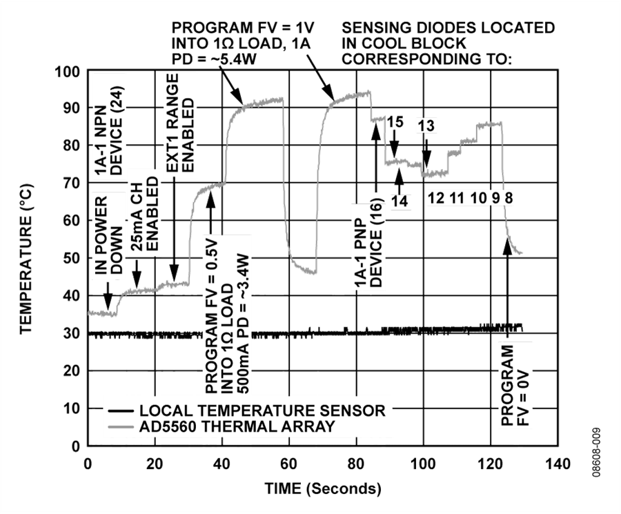

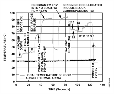

temperature measurement
An example of the temperature gradient measured with the ADT7461A is shown in Figure 9. The radiator used here is just a simple radiator and there is no air flow. The purpose is to help us understand the chip temperature gradient using the on-chip temperature diode at 1 A load; the power consumption is approximately 5.4 W. Diodes are numbered (as per the data sheet); this example cycles through a number of diodes at different points in time. Even with this simple heat sink, you can see a 17°C temperature difference across the chip.
Figure 6. Typical linearity performance when measuring FVMV (forced voltage, measured voltage) linearity error referred to the device under test using the AD7685; +28 V, −5 V skew supply; Note: This includes FV error.
Figure 7. Typical linearity performance when measuring FVMV linearity error referred to the device under test using the AD7685; ±15 V symmetrical supplies; Note: FV error included
Figure 8. Typical linearity performance when measuring FVMI (forced voltage, measured current) linearity error using the AD7685; ±15 V symmetrical supplies.
Figure 9. Example of ADT7461A used as a temperature monitor (X-axis is time in seconds).
