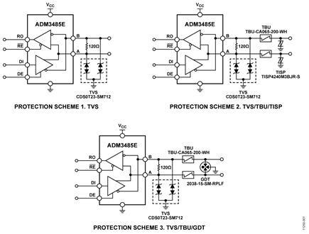

The circuit shown in Figure 1 uses the ADM3485E transceiver, a proven and tested electromagnetic compatibility (EMC) solution that provides triple protection for the widely used RS-485 communication port. Each solution is tested and characterized to ensure that the dynamic interactions between the transceiver and protection circuit elements work together to protect them from electrostatic discharge (ESD), electrical fast transients (EFT) and surges. Destruction - defined by IEC 61000-4-2, IEC 61000-4-4 and IEC 61000-4-5 standards respectively. This circuit uses the ADM3485E to provide proven ESD, EFT, and surge (common in harsh operating environments) protection for the RS-485 interface.
Figure 1. Three EMC-compliant ADM3485E protection circuits (schematic diagram, all connections not shown)

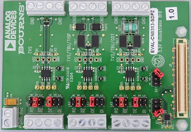

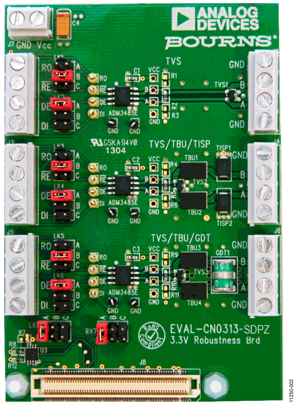

Figure 2 shows a physical photo of the EVAL-CN0313-SDPZ board. There are three ADM3485E devices on the board, one for each protection scheme. Each protection scheme provides the ESD and EFT protection described in this article and increases the level of surge protection.
For a complete design support package for the EVAL-CN0313-SDPZ board, including schematics, layout files, and bill of materials, see www.analog.com/CN0313-DesignSupport .
Figure 2. EVAL-CN0313-SDPZ board
The ADM3485E is a 3.3 V low-power data transceiver suitable for half-duplex communications on multipoint transmission lines. It has data rates up to 12 Mbps and a common-mode voltage range of −7 V to +12 V on the bus pins (A and B). Data is sent out through the DI pin and received through the RO pin. The outputs of both the driver and receiver can be enabled or disabled into a high-impedance state by changing the corresponding logic levels on the DE and RE pins.
Power and ground are connected to each other (V CC . and GND) through spiral cable connectors that are used by all three ADM3485E devices.
The DE and RE logic inputs are set via LK1 to LK6. For each ADM3485E, LK2, LK4, and LK6 are related to DE; LK1, LK3, and LK5 are related to RE . related. For each link, position A connects the logic pin to V. Position B connects the logic pin to GND. Position C connects the logic pin to the four-pin side screw cable connector. The input DI and output RO pins connect directly to the four-pin screw connector.
EVAL-CN0313-SDPZ is also compatible with Analog Devices' ezLINX™ board ( EZLINX-IIDE-EBZ ) and system development platform ( EVAL-SDP-CB1Z ). Connector J8 connects the UART and GPIO interfaces on the SDP or ezLINX board to the logic I/O of the ADM3485E device. The I/O connections and jumper configurations are shown in Table 2.

The ADM3485E transmitter and receiver share the same differential bus pins (A and B). Protection circuits are used to protect these bus pins.
In the first protection circuit (TVS, shown in Figure 1), a component is used, namely CDSOT23-SM712 from Bourns. It is a transient voltage suppressor (TVS) array on the EVALCN0313-SDPZ. It consists of two bidirectional TVS diodes optimized to protect RS-485 systems from as little overstress as possible while supporting the full range of RS-485 signals and common-mode voltage offsets. Under normal operating conditions, TVS has a high impedance to ground. When an overvoltage condition occurs, the TVS enters avalanche breakdown mode and clamps the pin voltage to a safe, predetermined level. It then diverts the transient current from the ADM3485E to ground.
This protection scheme provides up to 8 kV (contact discharge) and 15 kV (air discharge) ESD protection, 2 kV EFT protection and 1 kV surge protection.
As stated in the CDSOT23-SM712 data sheet, this device is designed for use with RS-485 devices. The following two protection schemes are applied to the CDSOT23-SM712 to provide more advanced circuit protection against surges.
In the second solution (TVS/TBU/TISP in Figure 1), the CDSOT23-SM712TVS provides the second level of protection, while Bourns' TISP4240M3BJR-S provides the first level of protection. TISP4240M3BJR-S is a fully integrated surge protector ( TISP ). TISP is a solid state thyristor. When its intended protection voltage is exceeded, the TISP provides a low-impedance path to ground, diverting most of the transient energy away from the ADM3485E.
Bourns' TBU-CA065-200-WH transient blocking unit ( TBU ) is a nonlinear overcurrent protection device located between the first and second level protection devices to ensure coordinated operation. TBU is an overcurrent blocking device that opens at a predetermined current. In blocking mode, it has a high impedance to block transient energy. This protection scheme provides up to 8 kV (contact discharge) and 15 kV (air discharge) ESD protection, 2 kV EFT protection and 4 kV surge protection.
The third level protection scheme ( TVS/TBU/GDT in Figure 1) works similarly to protection scheme 2. This scheme uses a gas discharge tube (GDT) instead of a TISP. The GDT protects against higher overvoltage and overvoltage conditions than the aforementioned TISP protection scheme. Current protection is provided. The GDT is a gas discharge plasma device that provides a low impedance ground path to prevent overvoltage transients. The selected GDT is Bourns' 2038-15-SM-RPLF.
This third level protection scheme provides up to 8 kV (contact discharge) and 15 kV (air discharge) ESD protection, 2 kV EFT protection and 6 kV surge protection.
The ADM3485E has a 120 Ω pin connected to the bus pin.
