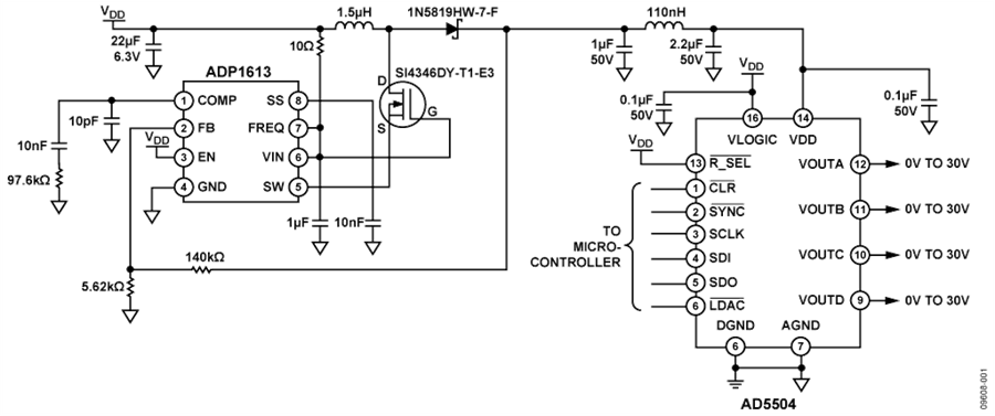

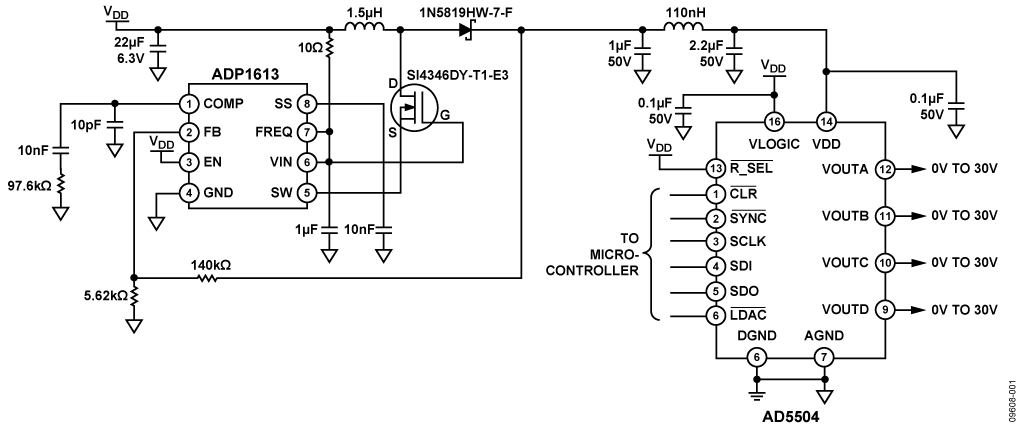

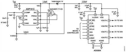

Figure 1. Boost supply and high-voltage DAC provide tuning signal to BST capacitor (simplified schematic: not all connections shown)
Circuit description
This circuit can operate with a 3 V (V DD ) supply, the BST capacitor requires more than 20 V for full control. The two main circuit modules are the ADP1613 boost switching converter and the AD5504 high-voltage DAC. The circuit diagram is shown in Figure 1.
The ADP1613 is a step-up DC-DC switching converter with an integrated power switch capable of delivering up to 20 V output. Higher output voltages can be achieved using other external components. The ADP1613 features an adjustable soft-start feature that prevents inrush current when the device is enabled. Pin-selectable switching frequency and PWM current mode architecture provide easy noise filtering and excellent transient response. Components connected around the ADP1613 produce a 32 V output from a 3 V input.
The ADIsimPower™ design tool provides designers with an easy way to determine appropriate components based on input and output requirements. The ADP1613 circuit design shown in Figure 1 uses ADIsimPower's "lowest cost" option with a 3 V input voltage, a 32 V output voltage, and a 40 mA load current. The design can be downloaded from www.analog.com/CN0193-PowerDesign .
ADIsimPower design files include a bill of materials, detailed schematics, Bode plots, efficiency curves, transient response, and recommended board layout.
The 32 V output of the ADP1613 is used as the power supply for the AD5504. The AD5504 is a quad-channel, 12-bit DAC capable of providing output voltages up to 60 V. The full-scale output of the AD5504 is determined by the state of the R_SEL pin. In this application, R_SEL is connected to V DD , so a full-scale output of 30 V is selected. The AD5504 is controlled by a 3 V logic compatible serial interface. The DAC output can be changed by writing to the appropriate DAC register through the serial interface. Multiple DACs can be updated simultaneously by pulsing the load DAC ( (LDAC) ) pin low, thus changing all four BST capacitors simultaneously.

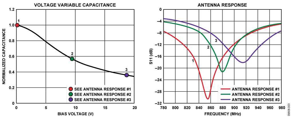

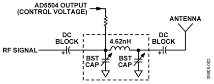

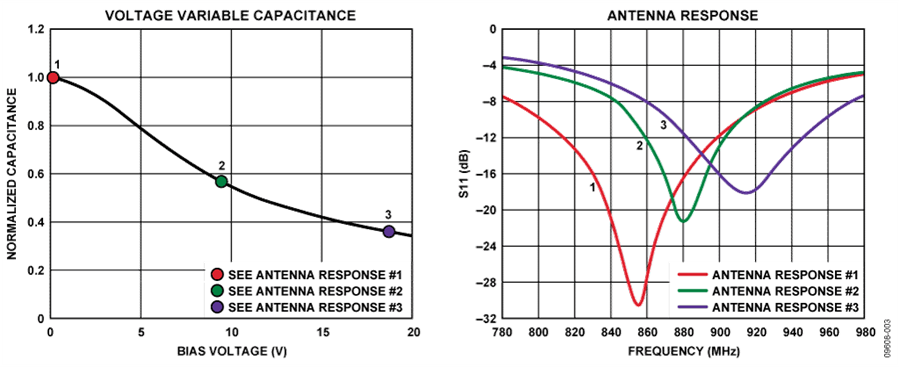

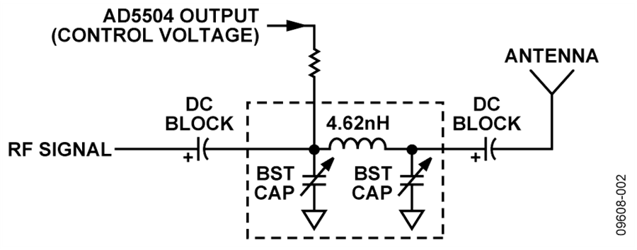

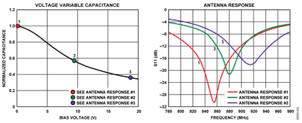

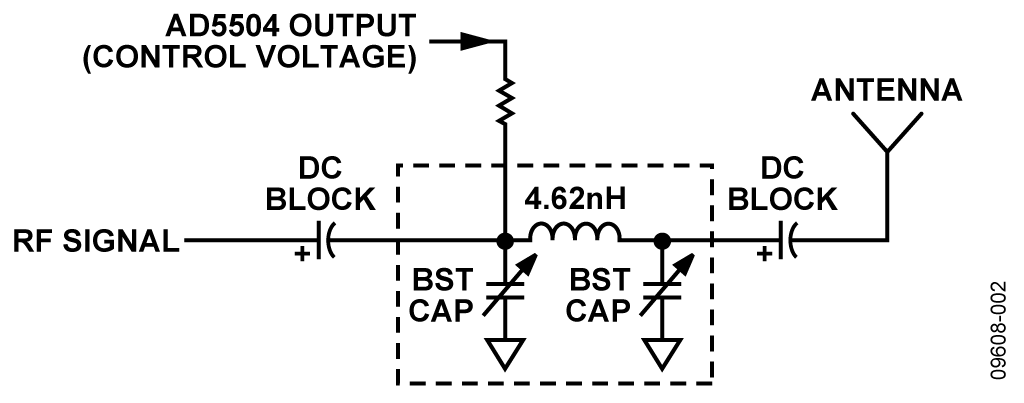

Using the circuit shown in Figure 1, DAC output voltages up to 30 V can be generated. The output voltage is used to set the bias voltage of the BST capacitor, thereby adjusting the antenna response. Figure 2 shows the equivalent circuit of the BST capacitor used as an adjustable matching network, and Figure 3 shows the transfer function of the BST capacitor as a function of bias voltage and the resulting antenna response. For more information on BST capacitors, please visit: www.agilerf.com .
Figure 2. BST capacitor equivalent circuit

Figure 3: Bias voltage versus BST capacitance and resulting antenna response
