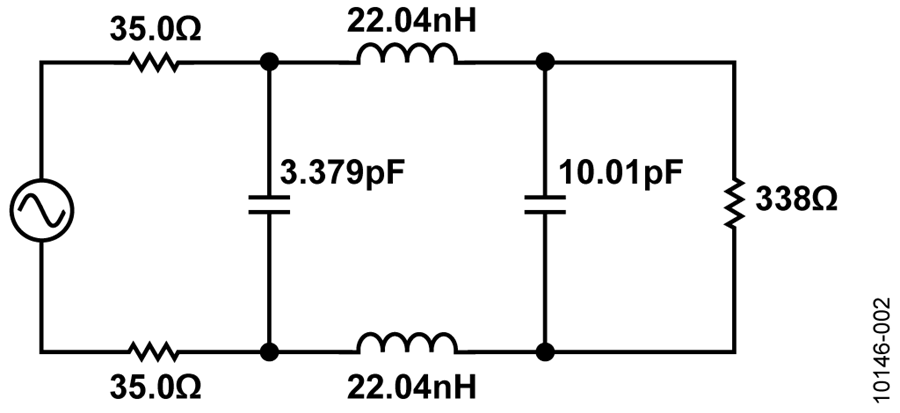

The third-order Butterworth filter is designed with a source impedance of 70 Ω, a load impedance of 338 Ω, and a 3 dB bandwidth of 360 MHz. The values ​​calculated by the program are shown in Figure 2.
Figure 2. Third-order differential Butterworth filter design, ZS = 70 Ω, ZL = 338 Ω, FC = 360 MHz
The values ​​chosen for the filter passive components are the closest standard values ​​to the program-generated values.
Subtract the ADC's internal 1.3 pF capacitance from the second shunt capacitance value (10.01 pF) to obtain a value of 8.71 pF. In this circuit, this capacitor is implemented using two 18 pF capacitors to ground, as shown in Figure 1. This can not only provide the same filtering effect, but also obtain a certain AC common mode suppression.

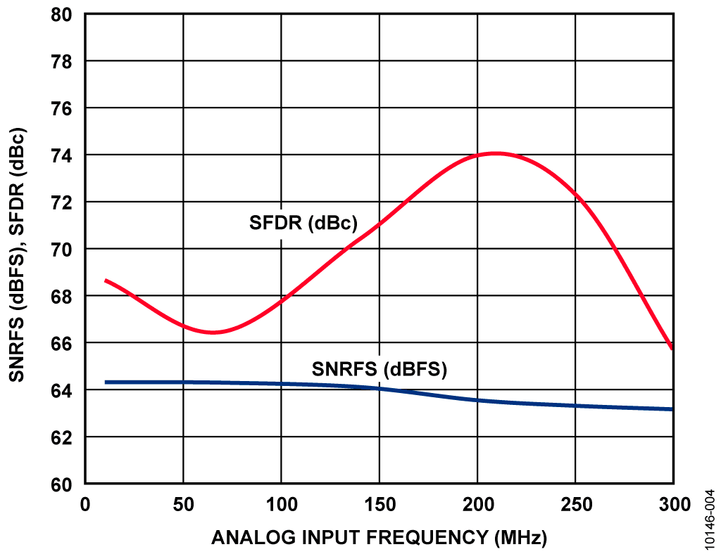

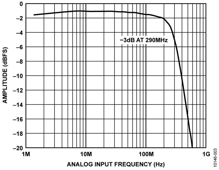

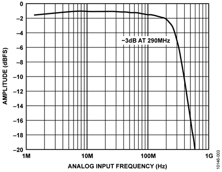

Table 1 summarizes the measured performance of the system with a 3 dB bandwidth of 290 MHz. The total insertion loss of the network is approximately 1.1 dB. Figure 3 shows the bandwidth response; Figure 4 shows the SNR and SFDR performance.

 Cutoff Frequency (-3 db)
 290MHz
 Pass-Band Flatness (6MHz to 200MHz)
 1 dB
 SNRFS@140MHz
 64.1dBFS
 SFDR@140MHz
 70.4 dBc
 H2/H3@140MHz
 85.0dBc/70.4dBc

Figure 3. Passband Flatness Performance vs. Frequency
Figure 4. SNR/SFDR performance versus frequency

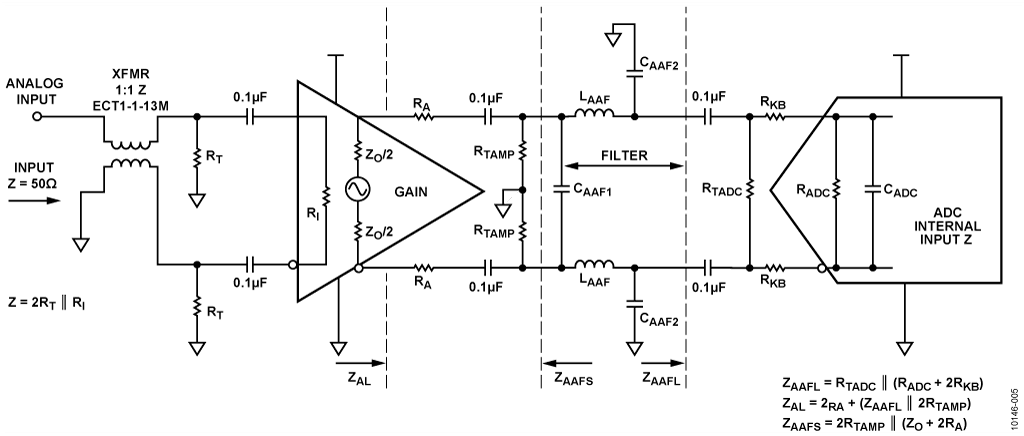

The general circuit shown in Figure 5 is applicable to most high-speed differential amplifier/ADC interfaces and will serve as the basis for this article's discussion. This design approach tends to take advantage of the relatively high input impedance of most high-speed ADCs and the relatively low impedance of the driving source (amplifier) ​​to minimize the insertion loss of the filter.
Figure 5. General differential amplifier/ADC interface with low-pass filter
The basic design process is as follows:
  1. Select the external ADC termination resistor RTADC so that the parallel combination of RTADC and RADC is between 200 Ω and 400 Ω
  2. Choose RKB based on experience and/or ADC data sheet recommendations, typically between 5 Ω and 36 Ω.
  3. Calculate the filter load impedance using the following equation:
    ZAAFL = RTADC || (RADC + 2RKB)
  4. S selects the amplifier external series resistor RA. If the amplifier differential output impedance is in the 100 Ω to 200 Ω range, RA should be less than 10 Ω. If the amplifier output impedance is 12 Ω or less, RA should be between 5 Ω and 36 Ω.
  5. Choose RTAMP so that the total load ZAL obtained by the amplifier is best suited for the specific differential amplifier selected by the following formula:
    ZAL = 2RA + (ZAAFL || 2RTAMP)
  6. Calculate filter source impedance
    ZAAFS = 2RTAMP || (ZO + 2RA)
  7. Use a filter design program or table to design a filter using source impedance, load impedance, ZAAFS and ZAAFL, filter type, bandwidth, order, etc. The bandwidth is approximately 40% greater than half the sample rate to ensure flatness from dc to fs/2.
  8. The internal ADC capacitance CADC should be subtracted from the final shunt capacitance value generated by the program. The program will give the differential shunt capacitor value CSHUNT2. The final common mode shunt capacitor is:
