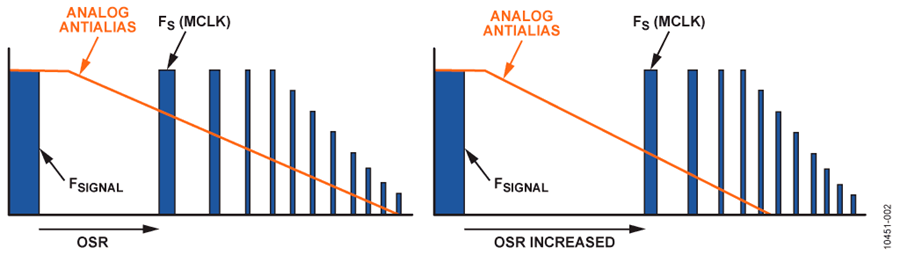

Oversampling is the process of sampling an input signal at a rate much higher than the Nyquist frequency. Generally speaking, every time the sampling frequency is doubled, the noise performance within the original signal bandwidth can be improved by approximately 3 dB. The oversampling ADC is followed by digital post-processing to remove noise outside the signal bandwidth, as shown in Figure 2.

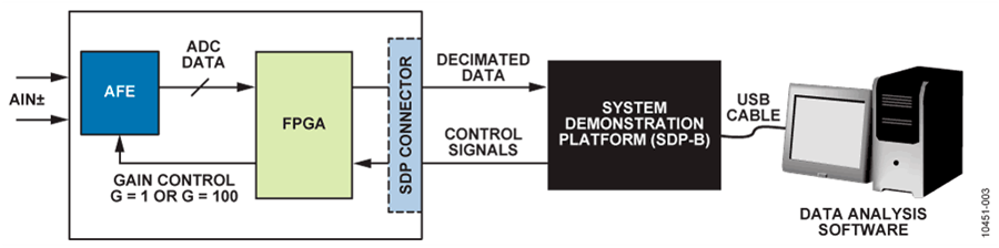

To complete the prototyping of the digital side of this application, a field programmable gate array (FPGA) is used as the digital core. In order to quickly debug the system, the analog circuit and FPGA are integrated on a single circuit board using the System Demonstration Platform (SDP) connector standard to easily implement USB connection to the PC, as shown in Figure 3. SDP is a combination of reusable hardware and software that can easily implement hardware control and data acquisition on most common component interfaces.

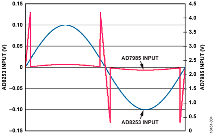

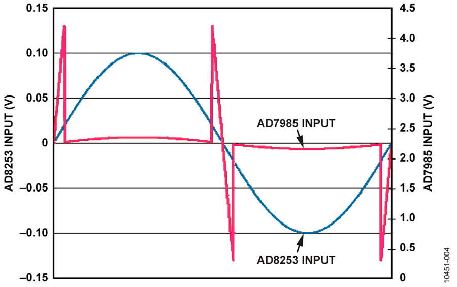

In G=1 mode, internal limits T1 and T2 are used. If the actual ADC result is between T1 and T2, the gain switches to G = 100 mode. This ensures that the ADC's analog input voltage is maximized as quickly as possible. Next, in G = 100 mode, the external limits T3 and T4 are used. If the predicted ADC result is above T3 or below T4, the gain is switched to G = 1 mode to prevent the ADC input from going over range, as shown in Figure 4.
Figure 4. Gain reduction of 100 from amplifier input to converter input when the analog-to-digital converter input is predicted to exceed the threshold limit (Blue line: amplifier input; red line: converter input.)
In G = 100 mode, if the algorithm predicts that the next ADC sample will be just above the external threshold (using the most basic linear prediction), assuming the ADC result is +32510, then the gain switches to G = 1 and the next ADC result is +325 Instead of +32510.
