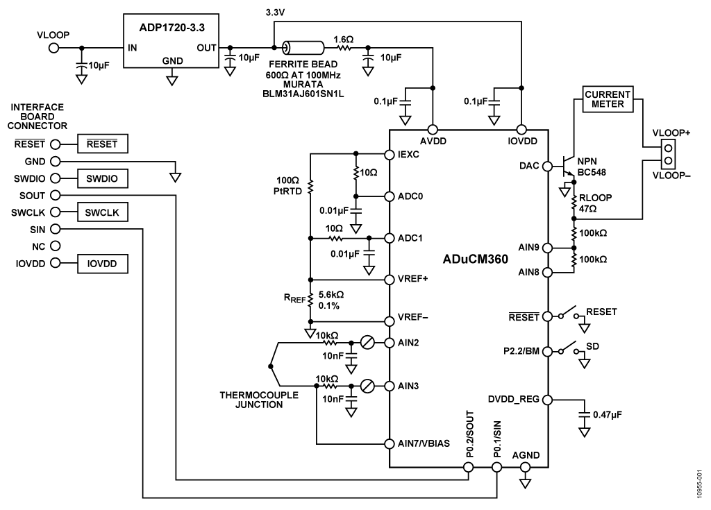

Figure 1. ADuCM360 with thermocouple interface used as a temperature monitor controller (schematic diagram, all connections not shown)

The following features of the ADuCM360 are used in this application :
  • The 12-bit DAC output and its flexible on-chip output buffer are used to control the external NPN transistor BC548. By controlling the V BE voltage of this transistor, the current through the 47Ω load resistor can be set to the desired value.
  • The DAC is 12-bit monotonic, but its output accuracy is usually around 3 LSB. Additionally, bipolar transistors introduce linearity errors. To improve the accuracy of the DAC output and eliminate offset and gain endpoint errors, ADC0 measures the feedback voltage, which reflects the voltage across the load resistor (R LOAD ). Based on this ADC0 reading, the DAC output will be corrected by the source code. This provides ±0.5°C accuracy for outputs from 4 mA to 20 mA.
  • The 24-bit Σ-Δ ADC has a built-in PGA and a gain of 32 is set in the software for the thermocouple and RTD. ADC1 continuously switches between thermocouple and RTD voltage sampling.
  • A programmable excitation current source drives a controlled current through the RTD. The dual-channel current source is configurable in steps from 0µA to 2 mA. This example uses a 200µA setting to minimize errors caused by RTD self-heating effects.
  • The ADC in the ADuCM360 has a built-in 1.2 V reference voltage source. The internal reference voltage source is highly accurate and suitable for measuring thermocouple voltages.
  • External voltage reference source for the ADC in the ADuCM360. When measuring the RTD resistance f, we use a ratiometric setup with an external reference resistor (R REF ) connected to the external VREF+ and VREF− pins. Since the reference in this circuit is high impedance, the on-chip reference input buffer needs to be enabled. An on-chip reference buffer means no external buffers are required to minimize input leakage effects.
  • Bias voltage generator (VBIAS). The VBIAS function sets the thermocouple common-mode voltage to AVDD/2 (900 mV). Again, this eliminates the need for external resistors to set the thermocouple common-mode voltage.
  • ARM Cortex-M3 core. The powerful 32-bit ARM core integrates 126 KB of flash and 8 KBSRAM memory to run user code, configure and control the ADC, and use the ADC to convert thermocouple and RTD inputs into final temperature values. It can also utilize closed-loop feedback control from the AIN9 voltage level and continuously monitor the DAC output. For additional debugging purposes, it can also control communication on the UART/USB interface.
  • The UART is used as a communication interface with the PC host. This is used to program the on-chip flash memory. It also serves as a debug port for calibrating the DAC and ADC.
  • Two external switches are used to force the device into flash boot mode. By holding SD low while toggling the RESET button, the ADuCM360 will enter boot mode instead of normal user mode. In boot mode, the internal flash memory can be reprogrammed via the UART interface.
  • The J1 connector is an 8-pin dual in-line connector that interfaces with the USB-SWD/UART board included with the CN0300 support hardware. This application circuit board can be programmed and debugged with the J-Link-Lite board. See Figure 3.

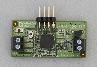

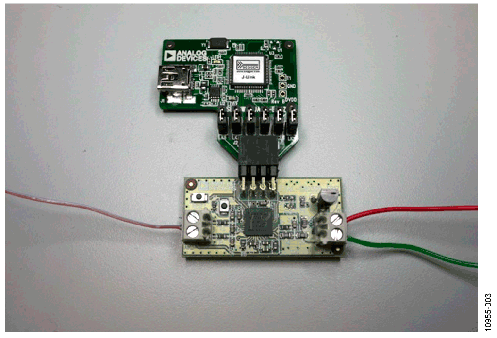

The PCB used to evaluate this circuit is shown in Figure 2.
Figure 2. EVAL-CN0300-EB1Z board used in this circuit

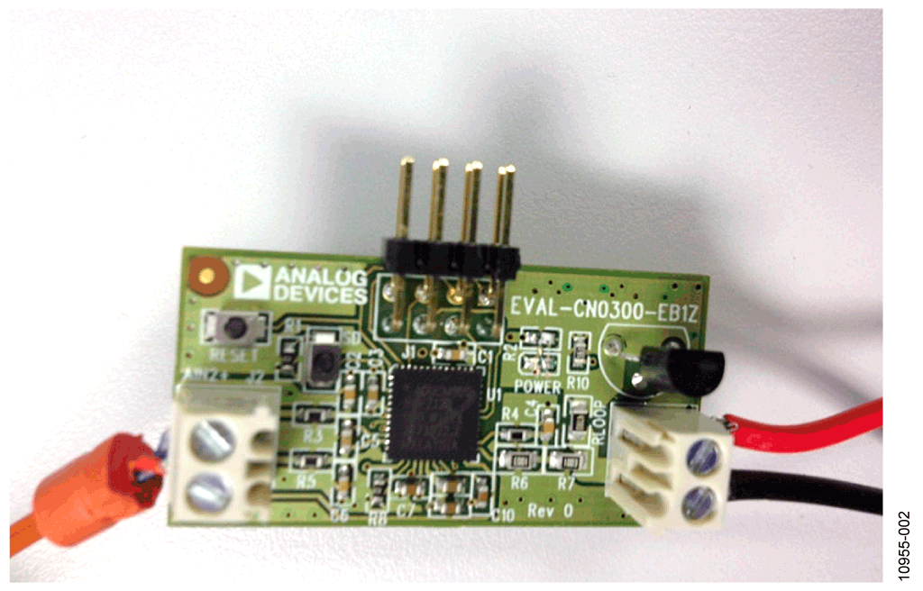

Figure 3. EVAL-CN0300-EB1Z board connected to USB-SWD/UART board and SEGGER J-Link-Lite board
ADI's J-Link OB emulator (USB-SWD/UART-EMUZ) supports:
  • When plugged into a PC USB port, it can also be used to connect to a COM port (virtual serial port) on the PC. This is required to run the calibration procedure.
  • Provides SW (serial wire) debugging and programming capabilities for the ADuCM360.

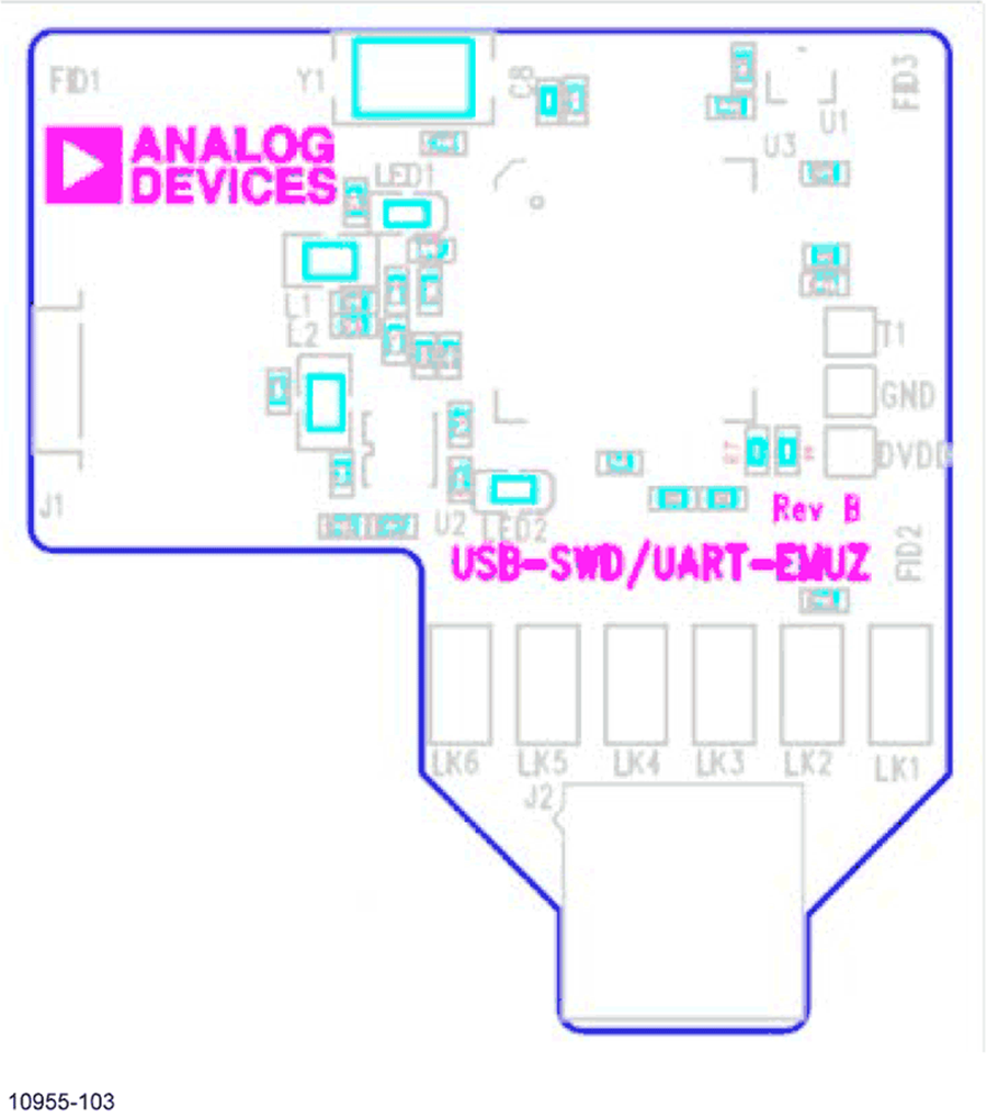

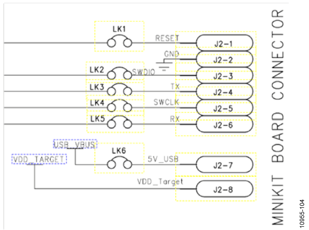

  • Figure 4 shows a top view of the emulator board. The J2 connector plugs into the EVAL-CN0300-EB1Z board. The J2 connector pinout is shown in Figure 5
Figure 4. Top view of Analog Devices’ J-Link OB emulator
Figure 5.J2 connector
For downloading and debugging, LK1, LK2, LK4 and LK6 must be inserted. LK3 and LK5 are used for communication via UART. The software required for J-Link OB is included in the software installation.
Please note that the J-Link OB emulator replaces the J-Link Lite and related interface boards previously shipped with the ADuCM360 development system.

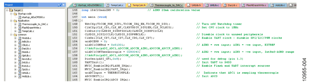

The source code link used to test the circuit is in the CN0300 Design Support package: http://www.analog.com/CN0300-DesignSupport . The source code uses the function library provided with the sample code. Figure 6 shows the list of source files used in the project when viewed with the Keil μVision4 tool.
Figure 6. Source files seen in μVision4

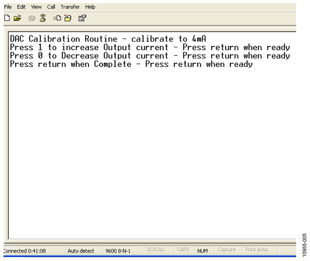

To calibrate the ADC or DAC, the interface board (USB-SWD/UART) must be connected to J1 and the USB port on the PC. You can use a COM port viewing program such as HyperTerminal to view the calibration menu and perform the calibration procedure step by step.
When calibrating the ADC, the source code prompts the user to connect the zero-scale and full-scale voltages to AIN2 and AIN3. Note that AIN2 is the positive input terminal. After completing the calibration procedure, the new calibration values ​​of the ADC1INTGN and ADC1OF registers are stored in the internal flash memory.
When calibrating the DAC, the VLOOP+ output should be connected through an accurate ammeter. The first part of the DAC calibration procedure calibrates the DAC to set the 4 mA output, and the second part calibrates the DAC to set the 20 mA output. The DAC code to set the 4 mA and 20 mA outputs is stored in flash memory. The voltage measured at AIN9 for the final 4 mA and 20 mA settings is also recorded and stored to flash memory. Since the voltage at AIN9 is linearly related to the current through RLOOP, these values ​​are used to calculate the DAC adjustment factor. This closed-loop approach means that all linearity errors on the DAC and transistor-based circuitry can be trimmed using the on-chip 24-bit Σ-Δ ADC.
UA RT is configured with a baud rate of 9600, 8 data bits, no polarity, and no flow control. If this circuit is directly connected to the PC, you can use a communication port viewing program such as "Hyper Terminal" to view the results sent by the program to the UA RT, as shown in Figure 7. .
To enter the characters required for the calibration procedure, type the required characters into the viewing terminal and the ADuCM360 UA RT port will receive the characters.

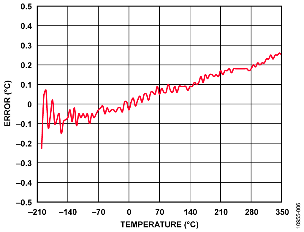

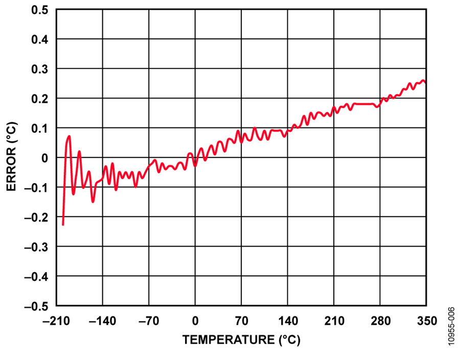

Figure 8 shows the error obtained when measuring 52 thermocouple voltages over the entire thermocouple operating range using ADC1 on the ADuCM360. The worst-case total error is less than 1°C.
Figure 8. Error when measuring 52 calibration points using ADuCM360/ADuCM361 using piecewise linear approximation method

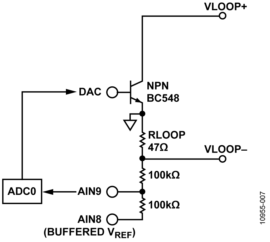

After measuring the final temperature, set the DAC output voltage to the appropriate value to produce the desired current on RLOOP. The input temperature range should be −200°C to +350°C. The code output current is 4 mA and 20 mA for the −200°C and +350°C settings, respectively. The code implements a closed-loop scheme, as shown in Figure 7, where the feedback voltage on AIN9 is measured through ADC0, and this value is then used to compensate for the DAC output setting. The FineTuneDAC(void) function performs this correction.
For best results, the DAC should be calibrated before beginning performance testing of this circuit.
Figure 9. Closed-loop control of 4 mA to 20 mA DAC output

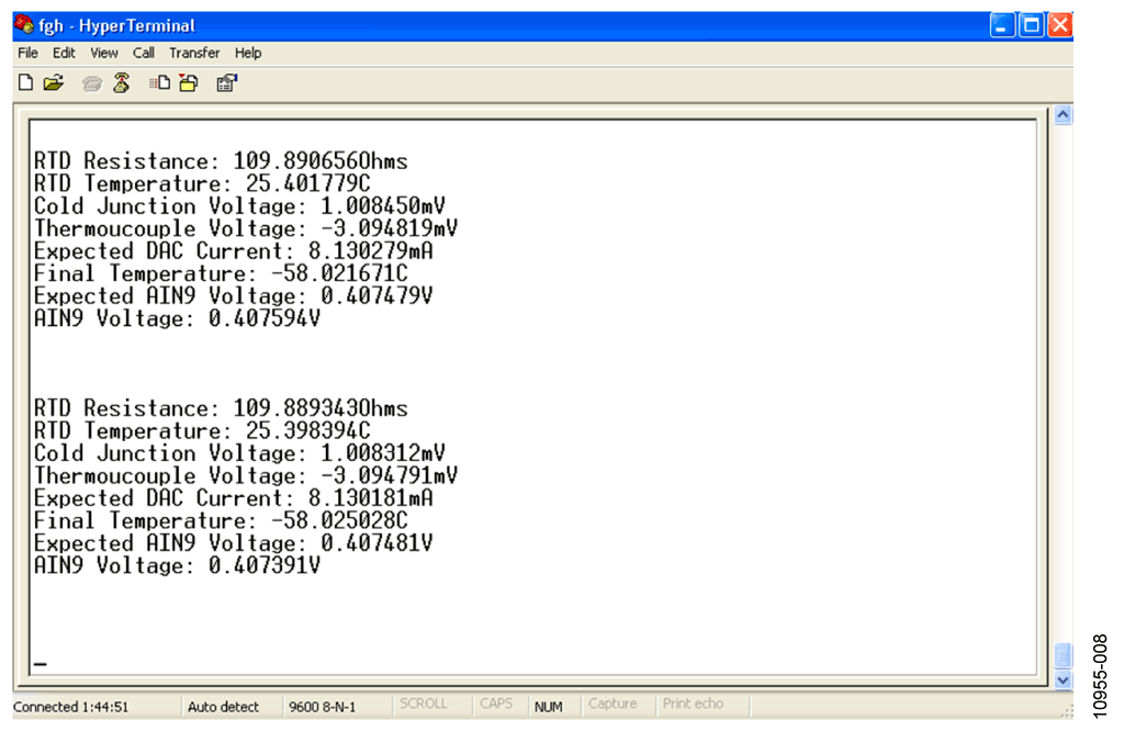

For debugging purposes, the following string is sent to the UART during normal operation (see Figure 10).
Figure 10. UART string for debugging
