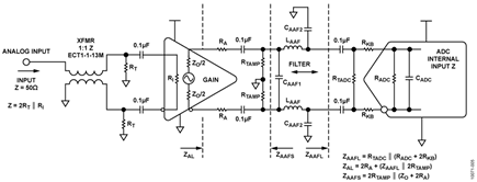

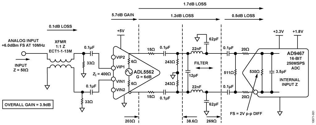

The circuit shown in Figure 1 is a wideband receiver front end based on the ADL5562 ultra-low noise differential amplifier driver and the AD9467 16-bit, 250 MSPS analog-to-digital converter .
The third-order Butterworth anti-aliasing filter is optimized based on the performance and interface requirements of the amplifier and ADC. The total insertion loss caused by the filter network and other components is only 1.8 dB.

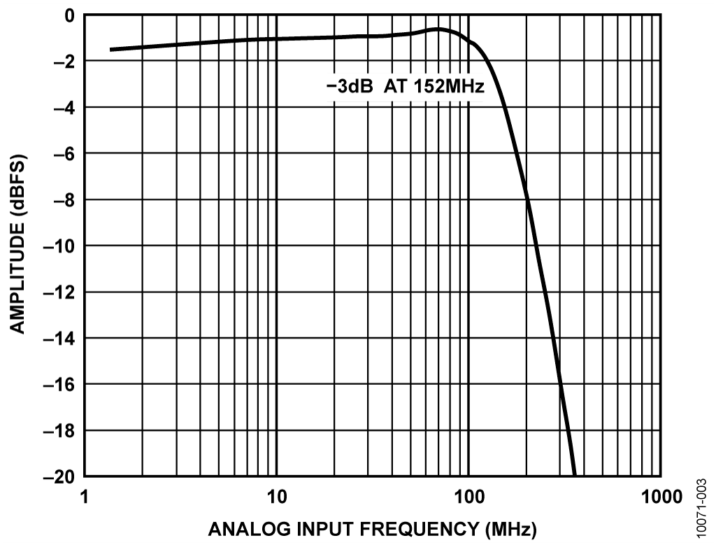

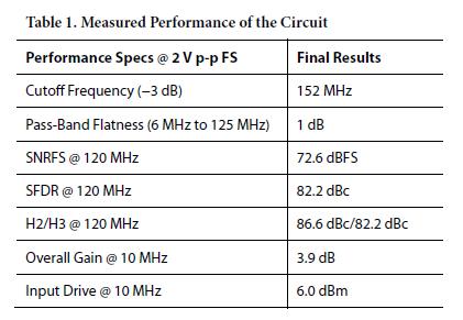

The overall 1 dB passband flatness of the circuit is 152 MHz. The measured SNR and SFDR at 120 MHz analog input are 72.6 dBFS and 82.2 dBc respectively.
Figure 1. 16-bit, 250 MSPS wideband receiver front end (schematic: decoupling and all connections not shown), gain, loss, and signal level measured at 10 MHz
Circuit description
This circuit accepts a single-ended input and converts it to differential form using a wide bandwidth (3 GHz) M/A-COM ECT1-1-13M 1:1 transformer. The 3.3 GHz differential amplifier ADL5562 has a differential input impedance of 400 Ω when operating at 6 dB gain and 200 Ω when operating at 12 dB gain. It also offers a 15.5 dB gain option.
The ADL5562 is an ideal driver for the AD9467. The fully differential architecture through the low-pass filter all the way to the ADC provides good high-frequency common-mode rejection and minimizes second-order distortion products. Depending on the input connection, the ADL5562 provides 6 dB or 12 dB of gain. This circuit uses 6 dB of gain to compensate for the insertion loss of the filter network and transformer (approximately 1.8 dB), resulting in a total signal gain of 3.9 dB.
An input signal of +6.0 dBm produces a 2 V pp full-scale differential signal at the ADC input.

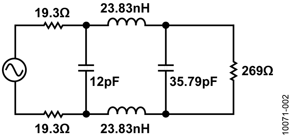

The anti-aliasing filter is a third-order Butterworth filter designed using standard filter design programs. The Butterworth filter was chosen because it provides a flat response within the passband. The third-order filter produces an AC noise bandwidth ratio of 1.05 and can be designed with the help of several free filter programs, such as Nuhertz Technologies Filter Free (www.nuhertz/filter) or Quite Universal Circuit Simulator (Qucs) Free Simulation (www.qucs .sourceforge.net) etc.
For best performance, the ADL5562 should be loaded with a 200 Ω net differential load. The 15 Ω series resistor isolates the filter capacitor from the amplifier output, and the 243 Ω resistor in parallel with the downstream impedance, plus the 30 Ω series resistor, results in a net load impedance of 203 Ω.
A 20 Ω resistor in series with the ADC input isolates the internal switching transients from the filter and amplifier. The 511 Ω resistor in parallel with the ADC is used to lower the input impedance of the ADC, making its performance more predictable. The design parameters of the third-order Butterworth filter are as follows: source impedance 38.6 Ω, load impedance 269 Ω, and 3 dB bandwidth of 180 MHz. The values ​​calculated by the program are shown in Figure 1. The filter passive component values ​​chosen are the standard values ​​that are closest to the values ​​calculated by the program.
Figure 2. Third-order differential Butterworth filter design: Z S = 38.6 Ω, Z L = 269 Ω, F C = 180 MHz
The value of the second parallel capacitor is subtracted from the ADC's 3.5 pF internal capacitance, resulting in a value of 32.29 pF. In this circuit, this capacitance is implemented using two 62 pF capacitors connected to ground, as shown in Figure 1. This achieves the same filtering effect and provides some AC common mode rejection.

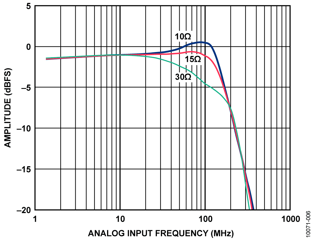

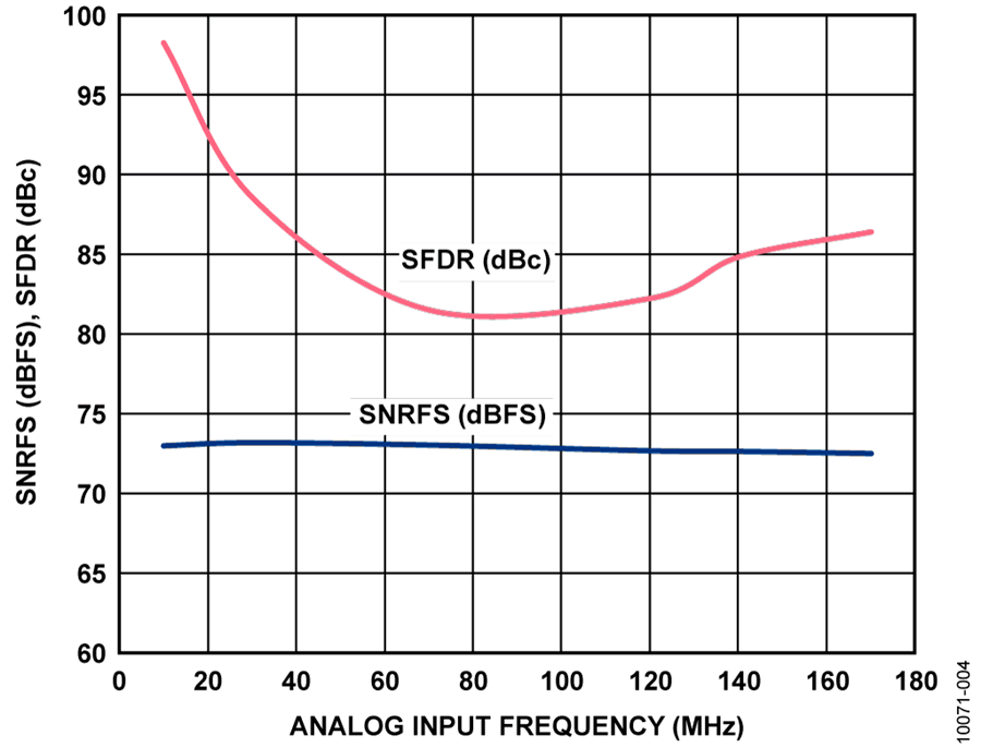

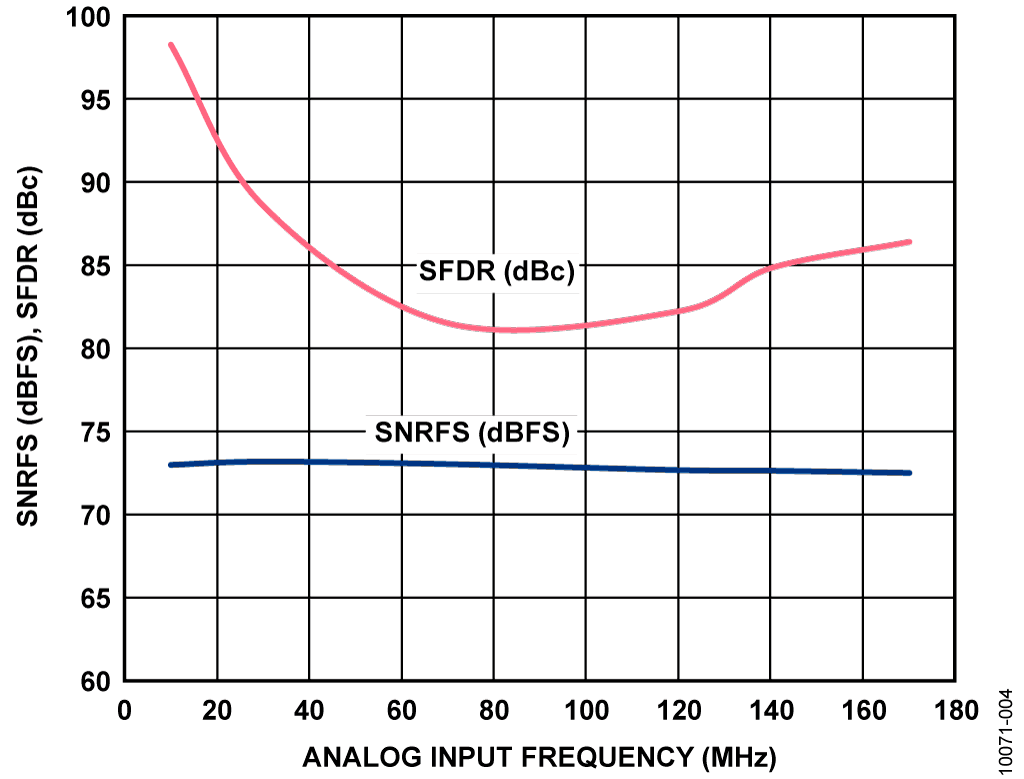

System performance measurements are summarized in Table 1 with a 3 dB bandwidth of 152 MHz. The total insertion loss of this network is approximately 2 dB. The bandwidth response is shown in Figure 3, and the SNR and SFDR performance are shown in Figure 4.
CN0227_table1
Figure 3. Passband Flatness Performance vs. Frequency
Figure 4. SNR/SFDR performance versus frequency

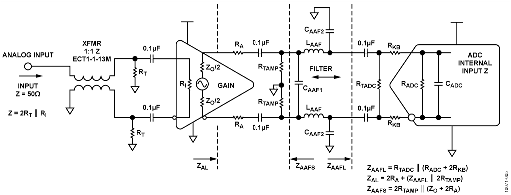

Figure 5. General interface of differential amplifier/ADC and low-pass filter
Filter and interface design program
This section explains the general approach to amplifier/ADC and filter interface design. In order to achieve optimal performance (bandwidth, SNR, SFDR, etc.), there are some design limitations of the amplifier and ADC that must be considered for this general circuit:
  • The amplifier should have the appropriate DC loading recommended by the data sheet for best performance.
  • Properly sized series resistors must be used between the amplifier and the load provided by the filter to prevent undesirable peaking in the passband.
  • The input to the ADC should be reduced by an external parallel resistor, and a suitable series resistor should be used to isolate the ADC from the filter. This series resistor also reduces peaking.
The generalized circuit shown in Figure 5 is applicable to most high-speed differential amplifier/ADC interfaces and will be used as the basis for the discussion. This design approach often minimizes the filter's insertion loss by taking advantage of the relatively high input impedance of most high-speed ADCs and the relatively low impedance of the driving source (amplifier).
The basic design process is as follows:
  • Choose the ADC external termination resistor R TADC so that the parallel impedance of R TADC and RA ADC is between 200 Ω and 400 Ω.
  • Choose R KB based on experience and/or ADC data sheet recommendations , typically between 5 Ω and 36 Ω.
  • Calculate the filter load impedance by:
    Z AAFL = R TADC || (R ADC + 2R KB )
  • Select the amplifier external series resistor R A . If the amplifier differential output impedance is between 100 Ω and 200 Ω, then R A . Should be less than 10 Ω. If the amplifier output impedance is 12 Ω or less, then R A . Should be between 5 Ω and 36 Ω.
  • R TAMP is chosen so that the total amplifier load Z AL is optimal for the particular differential amplifier chosen, as calculated by:
    Z AL = 2 RA + (Z AAFL || 2R TAMP )
  • Calculate the filter source impedance:
    Z AAFS = 2 RTAMP || (Z O + 2 RA )
  • Use the filter design program or table, as well as the source impedance Z AAFS , load impedance Z AAFL , filter type, bandwidth, order, etc., to design the filter. The bandwidth should be approximately 40% higher than half the sampling rate to ensure good enough flatness from DC to f/2 .
  • The final parallel capacitance value generated by the program should be minus the ADC internal capacitance C ADC . The program will give the value of the differential parallel capacitance C SHUNT2 , and the final common mode parallel capacitance is C AAF2 = 2(C SHUNT2 – C ADC ).
After completing the above preliminary calculations, a quick check of the following items of the circuit should be made.
  • The value of C AAF2 should be several times greater than C ADC and should be at least 10 pF. This is to minimize the filter 's sensitivity to changes in C ADC .
  • The ratio of Z AAFL to Z AAFS should be equal to or less than about 7, placing the filter within the limits of most filter tables and design programs.
  • The value of C AAF1 should be at least 5 pF to minimize the filter's sensitivity to parasitic capacitance and component changes.
  • The value of the inductor L AAF should be reasonable, at least several nH.
In some cases, a filter design program may provide more than one solution, especially for higher-order filters. At this time, a solution with the most reasonable combination of component values ​​should be selected. Additionally, the chosen configuration should end with a shunt capacitor that can be combined with the ADC input capacitance.

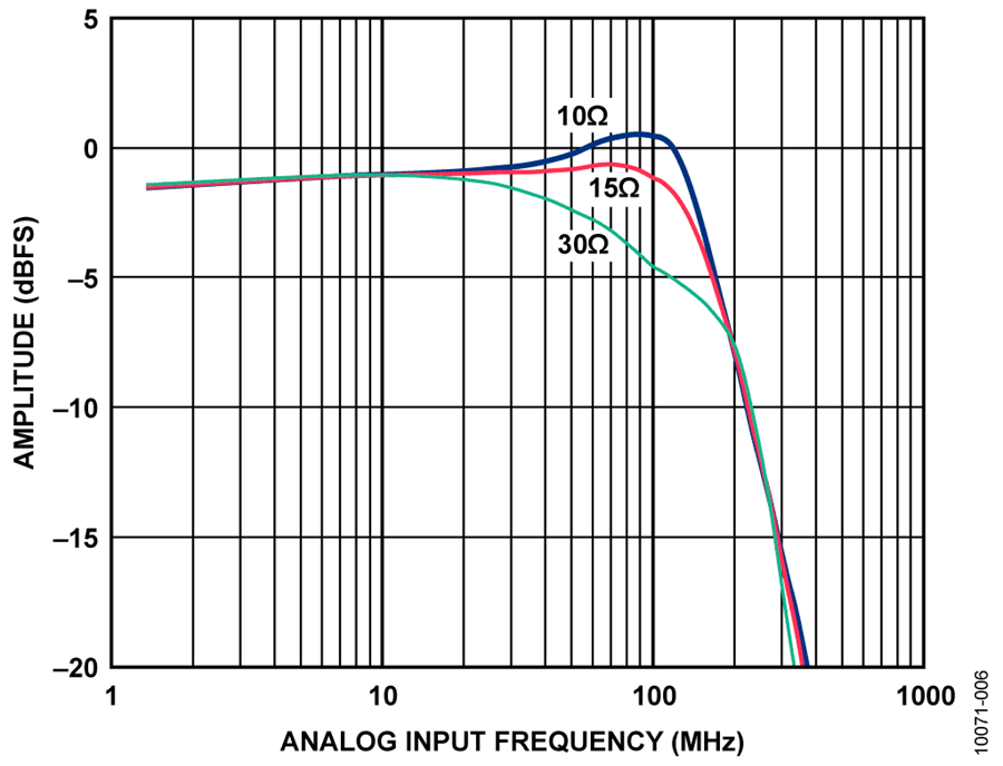

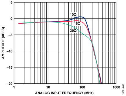

The parameters of this interface circuit interact with each other, so it is almost impossible to optimize all critical characteristics of the circuit (bandwidth, bandwidth flatness, SNR, SFDR, gain, etc.). However, by varying RA and RKB , the peaking that typically occurs in the bandwidth response can be minimized.
Notice in Figure 6 how the passband peaking decreases as the value of the output series resistor RA increases . However, the higher the value of this resistor, the greater the signal attenuation, and the amplifier must drive a larger signal to fill the ADC's full-scale input range.
The value of RA also affects SNR performance. Larger values ​​on the one hand reduce bandwidth peaking, but on the other hand tend to slightly increase SNR because the signal level required to drive the ADC full scale is higher.
The series resistor R KB at the ADC input should be chosen to minimize distortion caused by any residual charge injection into the ADC's internal sampling capacitor. Increasing this resistance also tends to reduce bandwidth peaking.
However, increasing R KB increases the signal attenuation, and the amplifier must drive a larger signal to fill the ADC's input range. Another way to optimize passband flatness is to slightly change the filter shunt capacitance CAAF2 .
The ADC input termination resistor R TADC should generally be selected so that the ADC net input impedance is between 200 Ω and 400 Ω. Lowering its value will reduce the effect of the ADC input capacitance and may make the filter design more stable, but the downside is that it will increase the insertion loss of the circuit. Increasing its value also reduces peaking.
Figure 6. Passband flatness performance versus amplifier output series resistance RA

The SFDR performance of this design depends on two factors: the amplifier and ADC interface component values ​​shown in Figure 1, and the AD9467’s internal front-end buffer bias current setting through internal registers. The final SFDR performance numbers shown in Table 1 and Figure 4 were obtained after optimizing the SFDR as described in the AD9467 data sheet.
Another factor that can be weighed in this particular design is the ADC full-scale setting. For the data obtained with this design (optimized for SFDR), the ADC full-scale differential input voltage was set to 2 V pp. Moving the full-scale input range to 2.5 V pp improves SNR performance by approximately 1.5 dB but slightly reduces SFDR performance. The input range is set by the value loaded into the AD9467 internal registers, see the data sheet for details.
