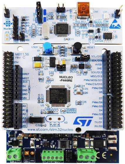

STM32 Nucleo package for IO-Link master with IO-Link v1.1 PHY and stack
P-NUCLEO-IOM01M1
The P-NUCLEO-IOM01M1 is an STM32 Nucleo pack composed of the STEVAL-IOM001V1 and the NUCLEO-F446RE boards. The STEVAL-IOM001V1 is a single IO-Link master PHY layer (L6360) while the NUCLEO- F446RE runs an IO-Link stack rev 1.1 (developed by and property of TEConcept GmbH, license limited to 10k minutes, renewable without additional costs). IO-Link stack update is allowed exclusively by following the procedure described in UM2421 (freely available at www.st.com). Any other erase/overwrite of the pre-loaded stack makes impossible to restore it.
The STM32 Nucleo pack provides an affordable and easy-to-use solution for the evaluation of IO-Link applications, L6360 communication features and robustness, together with the STM32F446RET6 computation performance. The pack, hosting up to four STEVAL-IOM001V1 to build a quad port IO-Link master, can access the IO-Link physical layer and communicate with IO-Link Devices.
You can evaluate the tool via the dedicated GUI (IO-Link Control Tool©, property of TEConcept GmbH) or use it as an IO-Link master bridge accessible from the dedicated SPI interface: source code of demo project (Low-Level IO-Link Master Access Demo Application, developed by TEConcept GmbH) and API specification are available for free.
Main features
  • IO-Link master stack v.1.1 (property of TEConcept GmbH):
    • renewable 10k minutes license
    • ready for new version update
  • STEVAL-IOM001V1
    • IO-Link master PHY based on L6360
    • Interrupt diagnostics pin
    • I²C and UART interface
    • SPI (slave) interface
    • 65 mA selectable (3.3 or 5.0 V) linear regulator
    • CQ (push-pull) and L+ (high side) switches
    • IQ additional IEC61131-2 type 1 digital input
    • L+ and CQ overload and overheating protections with non-dissipative cut-off function
    • QFN-26L (3.5x5x1 mm) package
    • Operating voltage range from 18 to 32.5 V
    • Additional high side switch for L+ heavy loads (IPS161H)
    • LEDs for status and diagnostics
    • Ground and VCC wire break protections
    • EMC compliance with IEC61000-4-2, IEC61000-4-3, IEC61000-4-5
    • Equipped with ST morpho connectors
    • CE certified
    • RoHS and China RoHS compliant
  • NUCLEO-F446RE
    • STM32F446RET6 32-bit Micro-controller based on ARM®Cortex®-M4 core (180 MHz max.) with 512-Kbyte Flash memory and 128 (+4) Kbyte RAM
    • Two types of extension resources: Arduino™ UNO Revision 3 connectivity and ST morpho extension pin headers for full access to all STM32 I/Os
    • Mbed-enabled (http://mbed.org)
    • On-board ST-LINK/V2-1 debugger/programmer with SWD connector: selection-mode switch to use the kit as a standalone ST-LINK/V2-1
    • Two push-buttons: USER and RESET
