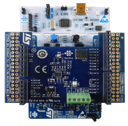

The P-NUCLEO-IOD01A1 is an STM32 Nucleo pack composed of the NUCLEO-L073RZ development board, the STEVAL-IOD003V1 evaluation board and the X-NUCLEO-IKS01A2 expansion board.
The STEVAL-IOD003V1 offers an IO-Link device PHY layer (L6362A) while the NUCLEO-L073RZ runs the IO-Link stack v1.1.3 included in the STSW-IOD01 (developed by and property of TEConcept Gmbh) and the firmware controlling the X-NUCLEO-IKS01A2 sensors.
The STM32 Nucleo pack provides an affordable and easy-to-use solution for the development of IO-Link and SIO applications, L6362A communication features and robustness, together with the STM32L073RZT6 computation performance.
Main features
  • Equipped with Arduino UNO R3 connectors and compatible with STEVAL-IOD003V1, X-NUCLEO-IKS01A2 and NUCLEO-L073RZ boards
  • The STEVAL-IOD003V1 features:
    • IO-Link (PHY) device layer based on L6362A
    • Operating voltage range 6.5 to 35 V
    • Dedicated CQ overload pin (wake-up)
    • Diagnostics pin (UVLO, overtemperature and cut-off)
    • UART interface
    • Linear regulators for independent supply from +24 V bus (12 mA 3.3 V and 100 mA 12 V)
    • LEDs for status and diagnostics
    • Overload and overheating protections with non-dissipative cut-off function
    • Full reverse polarity on IO-Link interface pins
    • EMC protections according to IO-Link v1.1 and IEC 60947-5-2
    • Ground and VCC wire break protections
  • The X-NUCLEO-IKS01A2 features:
    • LSM6DSL 3D accelerometer and 3D gyroscope
    • LSM303AGR 3D accelerometer and 3D magnetometer
    • LPS22HB pressure sensor
    • HTS221 capacitive digital relative humidity and temperature
    • DIL24 socket for additional MEMS adapters and other sensors
    • Free comprehensive development firmware library and samples for all sensors compatible with STM32Cube firmware
  • The NUCLEO-L073RZ features:
    • STM32L073RZT6 32-bit microcontroller based on ARM® Cortex®-M0+ core
    • Pre-programmed with STSW-IOD01 (IO-Link device stack v1.1.3)
    • Arduino UNO R3 connectivity and ST morpho extension pin headers
    • Mbed-enabled (http://mbed.org)
    • On-board ST-LINK/V2-1 debugger/programmer with SWD connector
