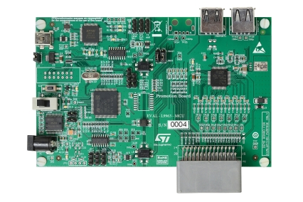

The EVAL-L9963-MCU is a hardware tool for evaluation of L9963, automotive chip for battery management applications. It can be used for the development of a 48 V battery management system (BMS) or as lower stage of a distributed BMS (depending on total battery voltage. Additional stages can be added thanks to EVAL-L9963-NDS).
EVAL-L9963-MCU allows the user to connect up to 14 channels for cell voltage sensing, one channel for current sensing, and up to 4 analog input for temperature sensing (plus an additional on-board NTC to sense PCB temperature). The board provides an onboard microcontroller with preloaded GUI firmware intended to be used with STSW-L9963 PC Graphical User Interface.
Main features
  • Measures from 4 to 14 cells in series, with 0 us desynchronization delay between samples. Supports also busbar connection without altering cell results
  • Coulomb counter supporting pack overcurrent detection in both ignition on and off states
  • Fully synchronized current and voltage samples
  • 16-bit voltage measurement
  • 2.66 Mbps isolated serial communication with regenerative buffer, supporting dual access ring
  • Transformer based isolation
  • Up to 4 analog inputs for NTC sensing, plus PCB temperature sensing
  • Onboard microcontroller SPC574S64E3 with 32-bit Power Architecture MCU for Automotive Chassis and Safety Applications
  • Onboard L9001 regulator as microcontroller power supply
