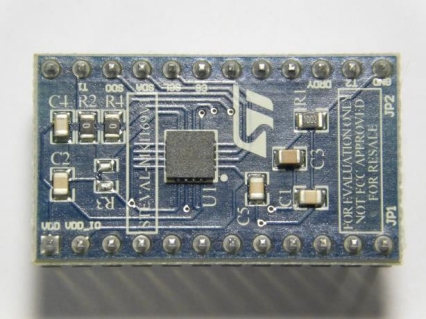

The STEVAL-MKI169V1 is an adapter board designed to facilitate the evaluation of MEMS devices in the I3G4250D product family. The board offers an effective solution for fast system prototyping and device evaluation directly within the user’s own application. The STEVAL-MKI169V1 can be plugged into a standard DIL 24 socket. The adapter provides the complete I3G4250D pin-out and comes ready-to-use with the required decoupling capacitors on the VDD power supply line. This adapter is supported by the STEVAL-MKI109V2 motherboard which includes a high performance 32-bit microcontroller functioning as a bridge between the sensor and a PC, on which it is possible to use the downloadable graphical user interface (Unico GUI), or dedicated software routines for customized applications.
