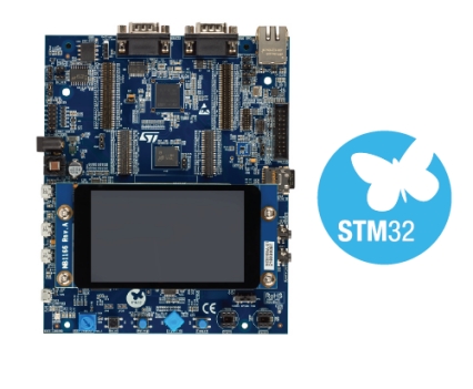

Evaluation board for STM32H757XI MCU
STM32H757I-EVAL
The STM32H747I-EVAL and STM32H757I-EVAL Evaluation boards (STM32H7x7I-EVAL) are high-end development platforms for the STM32H747XI and STM32H757XI microcontrollers, respectively. They are based on the high-performance Arm® Cortex®-M4 and Cortex®-M7 cores. The STM32H7x7I-EVAL Evaluation boards provide access to all the STM32 peripherals for user applications, and include an embedded STLINK-V3E debugger/programmer.
The full range of the STM32H7x7I-EVAL hardware features helps develop applications and evaluate all peripherals: USB OTG HS and FS, Ethernet, FD-CAN, USART, Audio DAC and ADC, digital microphone, SRAM, SDRAM, NOR Flash memory, Twin Quad-SPI Flash memory, microSD™ 3.0 card, 4" 480×800 TFT color LCD with MIPI DSI® interface and capacitive touchpanel, and cryptographic hardware accelerator (available only on STM32H757XI devices) .
The expansion connectors provide an easy way to add specialized features, while ETM trace is supported through external probes.
