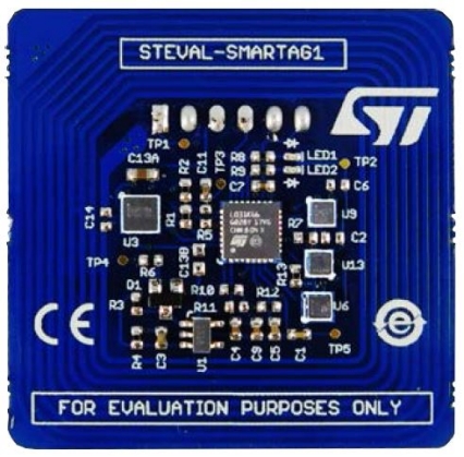

This smart and flexible NFC Tracker evaluation board with sensors includes a comprehensive software library and a sample application to monitor and log sensor data over NFC from an Android or iOS device.
The ultra-low power sensor node evaluation board mounts an ST25DV NFC Tag, an STM32L0 ARM Cortex M0+, environment sensors (temperature, humidity and pressure) and motion (accelerometer) sensor.
The evaluation board features NFC harvesting to supply power and a battery cradle for a CR2032 battery.
Main features
  • ST25DV64K dynamic NFC tag solution based on 64K-bit (8K-Byte) EEPROM and with I²C interface, Fast Transfer Mode and Energy Harvesting features
  • STM32L031K6 ultra-low-power ARM Cortex-M0+ MCU running at 32 MHz with 32-Kbytes Flash and 8-Kbytes RAM
  • LIS2DW12 ultra-low-power high-performance three-axis linear accelerometer
  • LPS22HB ultra-compact piezo-resistive absolute pressure sensor which functions as a digital output barometer: 260-1260 hPa
  • HTS221 capacitive digital sensor for relative humidity and temperature
  • STLQ015 low drop linear regulator power management
  • CR2032 Battery powered (not included)
  • STM32Cube function pack (FP-SNS-SMARTAG1)
  • Android (Google Play) and iOS demo apps (ST SmarTag)
  • Suitable for the following applications:
    • Internet of Things
    • Supply Chain and Cold-Chain Management
    • Smart building, home and city
    • Retail and apparel
    • Smart packaging
    • Medical and pharmaceutical
    • Batteryless sensing
    • Smart agriculture (soil control, animal tracking, etc.)
