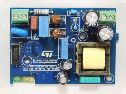

STEVAL-ILL083V1
The STEVAL-ILL083V1 evaluation board is an offline LED driver based on HVLED815PF and SPBTLE-RF very low power module for Bluetooth Smart v4.1 connectivity. The interfacing between the HVLED815PF and the SPBTLE-RF is managed by a STM32L0. The microcontroller and the connectivity module are supplied by the LED driver through the primary side auxiliary winding.
The embedded SPBTLE-RF Bluetooth v4.1 module lets you control the STEVAL-ILL083V1 board through the Smart Home Lighting Android™ application and can help reduce development and certification time.
The board can also be rendered visible to cloud applications with the addition of a wireless bridge.
Main features
  • LED driver main features
    • 10 W flyback converter with quasi-resonant operation
    • Primary side regulation, no optocoupler required
    • High power factor and low THD
    • Open/short LED management
    • ±1% LED current regulation
    • Dimming range: 2.5% to 100%
  • BLE connectivity main features
    • Works with Android App - Smart Home Lighting
    • Allows lamp remote power-on / power-off
    • Allows lamp remote dimming
  • Standby power consumption:
  • RoHS compliant
