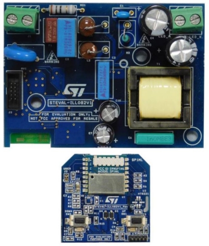

The STEVAL-ILL082V1 evaluation board is an offline LED driver based on the HVLED815PF, coupled with Sub-GHz connectivity based on the SPSGRF-868 low power programmable RF transceiver module. The interface between the HVLED815PF and the SPSGRF is managed by an STM32L0 ultra-low-power ARM® Cortex®-M0+ MCU. The microcontroller and connectivity module are supplied by the LED driver through an auxiliary winding.
The LED driver evaluation board can operate in standalone mode in communication with the bundled STEVAL-ILL082V1_Remote controller based on SP1ML to help to reduce development and certification time.
The board can also be rendered visible to cloud applications with the addition of a wireless bridge.

参考设计图片
