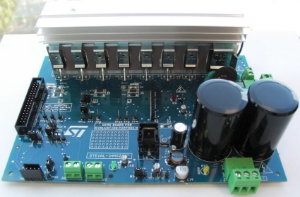

1 kW three-phase motor control evaluation board with L6390 driver and STGP10H60DF IGBT
STEVAL-IHM023V3
The STEVAL-IHM023V3 evaluation board implements a 1 kW three-phase motor control application featuring L6390 high and low-side driver and the STGP10H60DF IGBT. The evaluation board is an AC-DC inverter that generates a three-phase waveform for driving two- or three-phase motors such as induction motors or PMSM motors up to 1000 W, with or without sensors.
The STEVAL-IHM023V3 is a universal, fully evaluated and populated design consisting of a three-phase inverter bridge based on STMicroelectronics’ 600 V IGBT STGP10H60DF in a TO-220 package mounted on a heatsink, and the L6390 high-voltage high-side and low-side driver featuring an integrated comparator for hardware protection features such as overcurrent and overtemperature. The driver also integrates an operational amplifier suitable for advanced current sensing. Thanks to this advanced characteristic, the system achieves accurate and fast conditioning of the current feedback, addressing the typical requirements of field-oriented control (FOC). The board has been designed to be compatible with a single-phase mains, supplying from 90 VAC to 285 VAC or from 125 VDC to 400 VDC for DC voltage. With reconfiguration of the input sourcing, the board is suitable also for low-voltage DC applications up to 35 VDC.
Main features
  • Minimum input voltage: 125 VDC or 90 VAC
  • Maximum input voltage: 400 VDC or 285 VAC
  • Input voltage range with applied input voltage doubler from 65 VAC to 145 VAC
  • Voltage range for low-voltage motor control applications from 18 VDC to 35 VDC
  • Possibility to use auxiliary +15 V supply voltage
  • Maximum output power for motors: up to 1 kW
  • Regenerative brake control
  • Input inrush limitation with bypass relay
  • + 15 V auxiliary power supply based on buck converter with VIPer16
  • IGBT power switch STGP10H60DF in a TO- 220 package - compatible with other ST IGBTs or power MOSFETs in the TO-220 package
  • Fully populated board design with test points and isolated plastic cover for safety
  • Motor control connector for interface with the STM3210B-EVAL board and other ST motor control dedicated kits
  • Tachometer input
  • Hall/encoder inputs
  • Possibility to connect BEMF daughterboard for sensorless six-step control of BLDC motors
  • PCB type and size:
    • PCB material: FR-4
    • Double-sided layout
    • Copper thickness: 60 μm
    • Total dimensions of board: 127 mm x 180 mm
  • RoHS compliant
