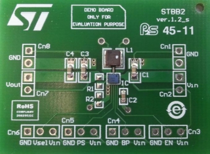

STBB2-based 800 mA, 3 MHz high-efficiency dual-mode buck-boost DC-DC converter
STEVAL-ISA109V1
The STEVAL-ISA109V1 is designed to aid in the evaluation of the STBB2, a high efficiency buck-boost DC-DC converter capable of providing regulated output voltages in the range of 1.2 V to 5.5 V with an input voltage between 2.3 V and 5.5 V.
The board comes pre-mounted with the adjustable version of the STBB2, with the output voltage set to 3.3 V. For this version, the VSELpin must be connected to VIN.
The board can also demonstrate the performance of the fixed version of the STBB2, by replacing R1 with a 0 Ω resistor and disconnecting R2.
Main features
  • Input voltage: from 2.3 V to 5.5 V
  • Output voltage: 3.3 V
  • Output current: 800 mA
  • Operating frequency: 3 MHz
  • RoHS compliant
