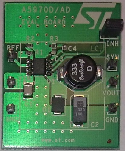

1A step-down switching regulator based on L5970D (Vin = 4 to 36V, Vout = 1.235 to Vin)
STEVAL-ISA088V1
The STEVAL-ISA088V1 demonstration board provides a platform for evaluation of the L5970D, a step-down monolithic power switching regulator capable of delivering up to 1 A of current at output voltages from 1.2 V to 35 V.
The input supply voltage of the STEVAL-ISA088V1 can range from 4.4 V to 25 V based on the rated voltage of the input capacitor, while the output voltage is adjustable from 1.235 V to VCC.
Main features
  • Max output current: 1 A
  • Output voltage from 1.235 V to 35 V
  • Operating input voltage from 4.4 V to 36 V
  • Internal switching frequency: 250 kHz
  • Synchronization pin for cases where a higher frequency (up to 500 kHz) is required
  • Short-circuit protection
  • Inhibit pin
  • Thermal shutdown
  • RoHS compliant
