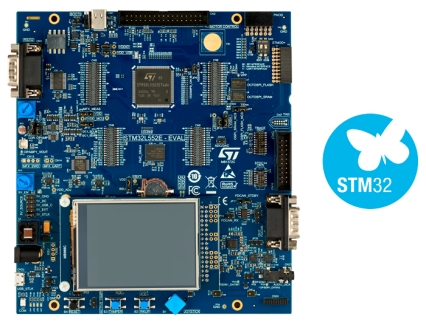

The STM32L552E-EV Evaluation board is designed as a complete demonstration and development platform for STMicroelectronics Arm® Cortex®-M33 core with Arm® TrustZone® and the ARMv8-M mainline security extension.
The STM32L552E-EV Evaluation board is based on an ultra-low-power STM32L552ZET6QU microcontroller with 512 Kbytes of Flash memory and 256 Kbytes of SRAM, one external memory interface supporting an LCD interface, one Octo-SPI memory interface, one USB Type-C™ FS with Power Delivery controller, two SAI ports, four I2C buses, six USART ports, three SPI interfaces, one CAN‑FD controller, one SDMMC interface, two 12-bit ADC, two 12-bit DAC, two operational amplifiers, two ultra-low comparators, four digital filters for sigma-delta modulator, up to 16 timers, touch-sensing capability, and debugging supported by SWD, JTAG and ETM interface.
The full range of hardware features on the board helps the user to evaluate all the peripherals (USB FS, USART, digital microphones, ADC and DAC, dot-matrix TFT LCD, LDR, SRAM, octal Flash memory device, microSD™ card, sigma-delta modulators, smartcard, CAN‑FD transceiver, I2C, EEPROM), and to develop applications. Extension headers allow easy connection of a daughterboard or wrapping board for a specific application.
An ST-LINK/V2-1 is integrated on the board, as embedded in-circuit debugger and programmer for the STM32 MCU and the USB Virtual COM port bridge.
Main features
  • STM32L552ZET6QU microcontroller featuring 512 Kbytes of Flash memory and 256 Kbytes of SRAM in LQFP144 package
  • 2.8" 240 × 320 pixel-262K color TFT LCD module with parallel interface and touch panel
  • USB Type-C™ Sink device FS
  • On-board current measurement
  • SAI Audio CODEC
  • ST-MEMS digital microphones
  • 512-Mbit Octal-SPI Flash, 64-Mbit Octal HyperRAM, 16-Mbit SRAM, 128-Kbit I2C EEPROM
  • Four user LEDs
  • User, Tamper and Reset push-buttons
  • 4-direction joystick with a selection button
  • Touch sensing button
  • Light-dependent resistor (LDR)
  • Potentiometer
  • Coin-battery cell holder for power backup
  • Power-metering demonstration with dual-channel, sigma-delta modulator
  • Board connectors:
    • Power jack
    • USB Type-C™
    • microSD™ card
    • Smartcard socket
    • Stereo headset jack including analog microphone input
    • Audio jack for external speakers
    • Two DB9 for external RS-232 port and CAN FD
    • JTAG and ETM trace debugger
    • Connectors for ADC input and DAC output
    • I/O expansion connectors
    • STMod+ expansion connector
    • Pmod™ expansion connector
    • Audio daughterboard expansion connector
    • Motor-control interface expansion connector
    • I2C expansion connector
  • Flexible power-supply options: ST-LINK, USB VBUS or external sources
  • On-board ST-LINK/V2-1 debugger/programmer with USB re-enumeration capability: mass storage, Virtual COM port, and debug port
  • Comprehensive free software libraries and examples available with the STM32CubeL5 MCU Package
  • Support of a wide choice of Integrated Development Environments (IDEs) including IAR™, Keil®, and STM32CubeIDE
