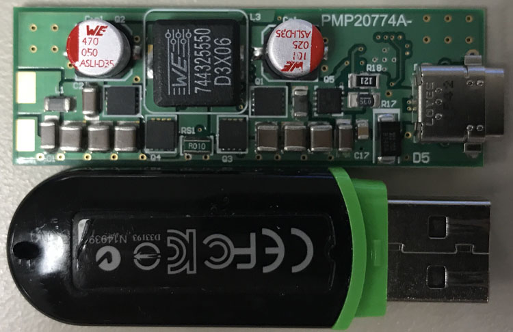

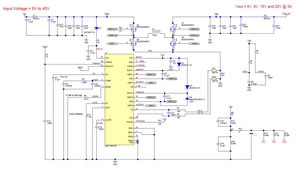

The PMP20774 reference design is a universal USB Type-C charger utilizing the LM5175 DC/DC and TPS25740B PD controller for aftermarket automotive charger applications. This design operates with a minimum input voltage of 6V and a maximum input voltage of 40V. This design is capable of delivering 3A continuously at 5Vout, 9Vout, 15Vout and 20Vout. The switching frequency is set to 350kHz. The waveforms are collected when the input voltage is 12V and 24V.
characteristic
  • ●Input voltage is 6V to 40V, output voltage is 5V/3A, 9V/3A, 20V/3A
  • ● Achieve 90% efficiency over the entire operating range, with a peak efficiency of 95%
  • ● Compact size and slim profile
  • ● Solution size: 57mm x 19mm
  • ● No firmware required, PD controller TPS25740
