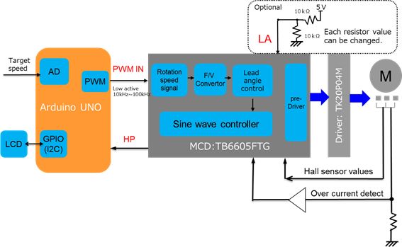

• TB6605FTG: Sine wave BLDC motor controller
• Power supply voltage: 10V-28V DC
• Included motor specifications: Medium speed motor 10V-24V/0.5A-10A/Output 26W/4000rpm
• Motor driver IC output + MosFET: N channel +N-channel MosFET (Toshiba TK20P04M1)
• Main ICs: TB6605FTG, TC75S51F, TK20P04M1 (Requires Arduino UNO in MCD+MCU mode.)
• MosFET specifications and packaging information: TK20P04M1: NMOS, 40V/20A, DPAK, Rdson=19mΩ
• This reference design provides a motor control closed-loop system using Toshiba's 3-phase brushless DC motor driver IC TB6605FTG.
• This board is designed as a plug-in board (shield board) for the Arduino UNO platform. efficiency.
Blockdiagram
