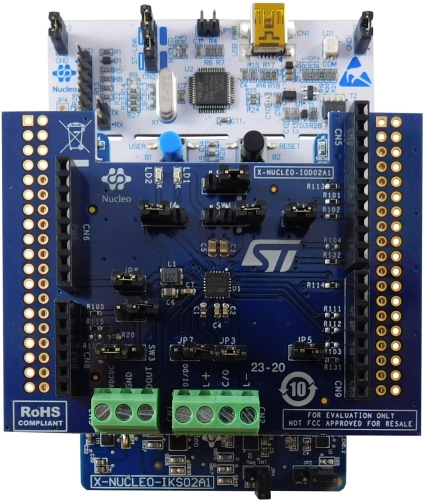

The P-NUCLEO-IOD02A1 is an STM32 Nucleo pack composed of the X-NUCLEO-IOD02A1 and X-NUCLEO-IKS02A1 expansion boards stacked on the NUCLEO-L452RE development board.
[P-NUCLEO-IOD02A1 IMAGE]
The X-NUCLEO-IOD02A1 features an IO-Link device transceiver for the physical connection to an IO-Link master, while the X-NUCLEO-IKS02A1 features a multi-sensor board for industrial applications, and the NUCLEO-L452RE features the necessary hardware resources to run the FP-IND-IODSNS1 function pack and to control the transceiver and multi-sensor boards.
The FP-IND-IODSNS1 combines an IO-Link demo stack library (derived from X-CUBE-IOD02) with the X-CUBE-MEMS1 and features an example of IO-Link device multi-sensor node.
The P-NUCLEO-IOD02A1 can be used for evaluation purpose and as development environment.
The STM32 Nucleo pack provides an affordable and easy-to-use solution for the development of IO-Link and SIO applications, evaluation of L6364Q communication features and robustness, together with the STM32L452RET6U computation performance.
