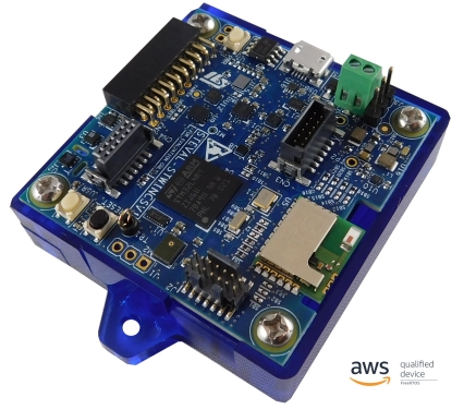

The STWIN SensorTile wireless industrial node (STEVAL-STWINKT1B) is a development kit and reference design that simplifies prototyping and testing of advanced industrial IoT applications such as condition monitoring and predictive maintenance.
[STEVAL-STWINKT1B IMAGE]
The kit features a core system board with a range of embedded industrial-grade sensors and an ultra-low-power microcontroller for vibration analysis of 9-DoF motion sensing data across a wide range of vibration frequencies, including very high frequency audio and ultrasound spectra, and high precision local temperature and environmental monitoring.
The development kit is complemented with a rich set of software packages and optimized firmware libraries, as well as a cloud dashboard application, all provided to help speed up design cycles for end-to-end solutions.
The kit supports BLE wireless connectivity through an on-board module, and Wi-Fi connectivity through a special plugin expansion board (STEVAL-STWINWFV1). Wired connectivity is also supported via an on-board RS485 transceiver. The core system board also includes an STMod+ connector for compatible, low cost, small form factor daughter boards associated with the STM32 family, such as the LTE Cell pack.
Apart from the core system board, the kit is provided complete with a 480 mAh Li-Po battery, an STLINK-V3MINI debugger and a plastic box.

Multi-sensing wireless platform implementing vibration monitoring and ultrasound detection
Built around STWIN core system board with processing, sensing, connectivity and expansion capabilities
Ultra-low-power ARM Cortex-M4 MCU at 120 MHz with FPU, 2048 kbytes Flash memory (STM32L4R9)
Micro SD Card slot for standalone data logging applications
Wireless BLE4.2 (on-board) and Wi-Fi (with STEVAL-STWINWFV1 expansion board), and wired RS485 and USB OTG connectivity
Option to implement Authentication and Brand protection secure solution with STSAFE-A110
Wide range of industrial IoT sensors:
ultra-wide bandwidth (up to 6 kHz), low-noise, 3-axis digital vibration sensor (IIS3DWB)
3D accelerometer + 3D Gyro iNEMO inertial measurement unit (ISM330DHCX) with machine learning core
ultra-low-power high performance MEMS motion sensor (IIS2DH)
ultra-low-power 3-axis magnetometer (IIS2MDC)
digital absolute pressure sensor (LPS22HH)
relative humidity and temperature sensor (HTS221)
low-voltage digital local temperature sensor (STTS751)
industrial grade digital MEMS microphone (IMP34DT05)
analog MEMS microphone with frequency response up to 80 kHz (IMP23ABSU)
