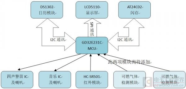

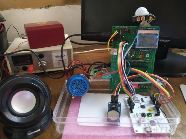

The overall idea of the project is to use the GD32E231 development board as the main control unit, use the LCD5110 display screen and two user buttons as the human-computer interaction module, use the infrared probe for monitoring, and use the AT24C02flash chip to save and record the triggering time of the monitoring alarm, so that Initial implementation of basic intelligent functions.
Blockdiagram
