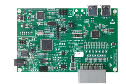

EVAL-L9963E-MCU:L9963E Evaluation Board with on board MCU with preloaded firmware (GUI)
The EVAL-L9963E-MCU is a hardware tool for evaluation of L9963E, automotive chip for battery management applications. It can be used for the development of a 48 V battery management system (BMS) or as lower stage of a distributed BMS (depending on total battery voltage. Additional stages can be added thanks to EVAL-L9963E-NDS).
[EVAL-L9963E-MCU Image]
EVAL-L9963E-MCU allows the user to connect up to 14 channels for cell voltage sensing, one channel for current sensing, and up to 4 analog input for temperature sensing (plus an additional on-board NTC to sense PCB temperature). The board provides an onboard microcontroller with preloaded GUI (graphical user interface) firmware intended to be used with STSW-L9963E PC GUI.
All features
Measures from 4 to 14 cells in series, with 0 μs desynchronization delay between samples. Supports also busbar connection without altering cell results
Coulomb counter supporting pack overcurrent detection in both ignition on and off states
Fully synchronized current and voltage samples
16-bit voltage measurement
2.66 Mbps isolated serial communication with regenerative buffer, supporting dual access ring
Transformer based isolation
Up to 4 analog inputs for NTC sensing, plus PCB temperature sensing
Onboard microcontroller SPC574S64E3 with 32-bit Power Architecture MCU for automotive chassis and safety applications
Onboard L9001 regulator as microcontroller power supply
Hot plug dedicated circuit
