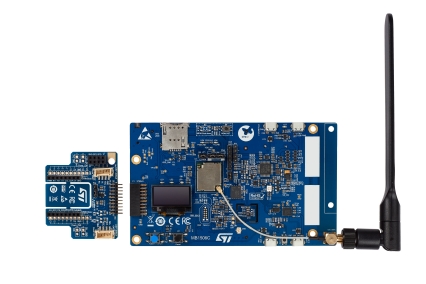

The B-L462E-CELL1 Discovery kit is a turnkey development platform for cellular IoT devices. The Discovery kit contains a low-power Discovery main board powered by an LBAD0ZZ1SE module, a global coverage antenna, and a fan-out board. The LBAD0ZZ1SE includes an STM32L462REY6TR microcontroller, an LBAD0XX1SC-DM ultra-small LTE Cat M/NB modem, and an ST4SIM GSMA-certified embedded SIM.
STMod+ and extended pins connectivity provide unlimited expansion capabilities with a large choice of specialized add-on boards. Moreover, the fan-out board supports add-on boards using mikroBUS, ESP‑01, Grove I2C, Grove UART, and breadboard. The B-L462E-CELL1 Discovery kit includes an ST-LINK debugger/programmer and comes with the comprehensive STM32Cube software libraries together with packaged software examples to seamlessly connect to cloud servers.
