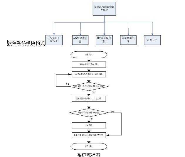

This design uses LM3S811 as the processor of the lubricating oil dielectric constant detection device, designs the AD5933 impedance measurement circuit, extracts capacitive reactance information from the impedance data, and calculates the change in the lubricating oil dielectric constant based on the change in capacitance to achieve lubrication control. Test the dielectric constant of oil and record the data to find out the change pattern between lubricating oil quality and dielectric constant.
Blockdiagram
