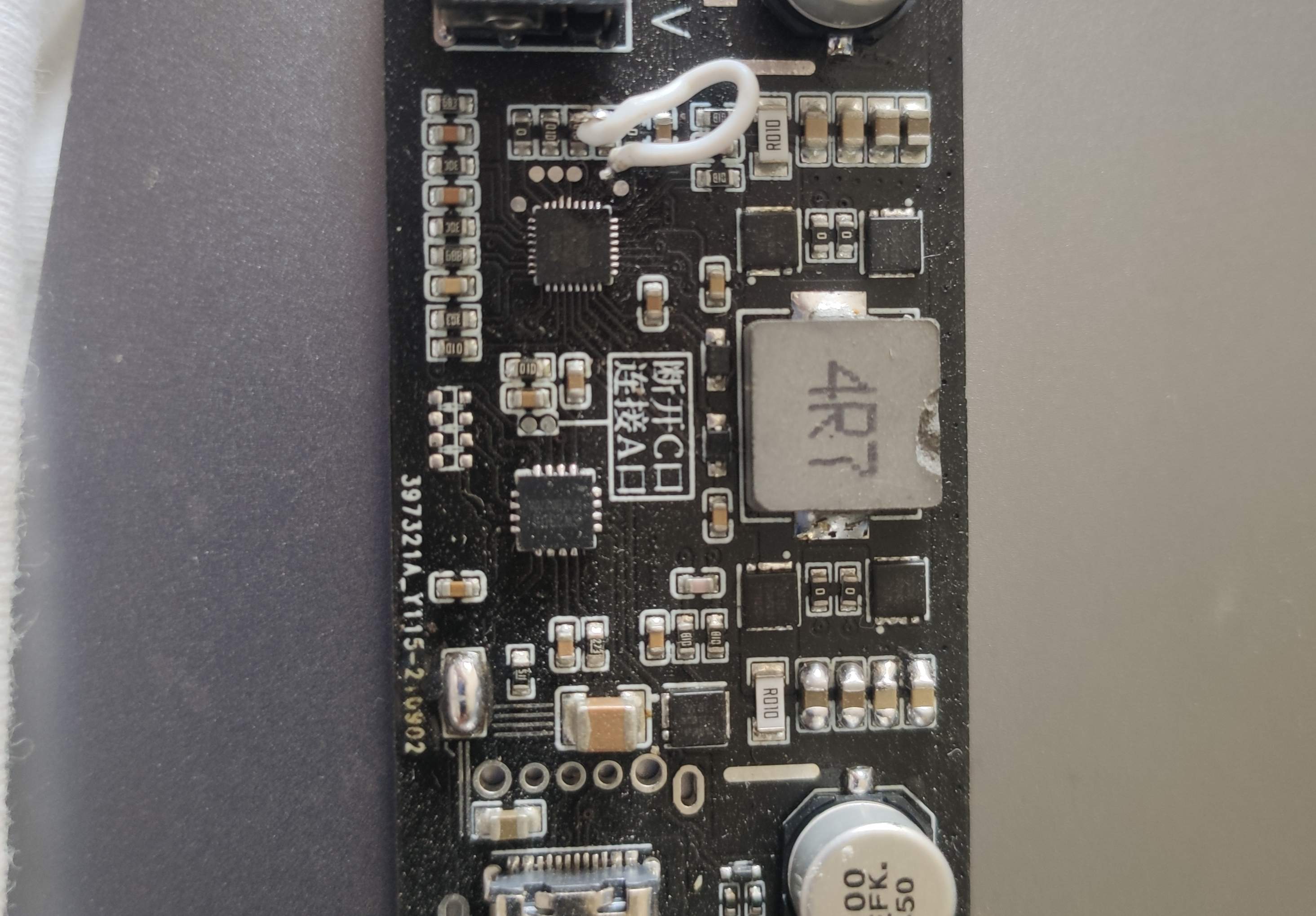

Using SC8701 buck-boost chip and SW2303 protocol chip to achieve fast charging
Maximum 100W. The mos tube needs to be improved and the heat dissipation stronger. Try not to run it at full power.
Forget about using PWM improved
Tested fast charging protocol as shown below
The 20V voltage range can activate the tester but there is no display.
