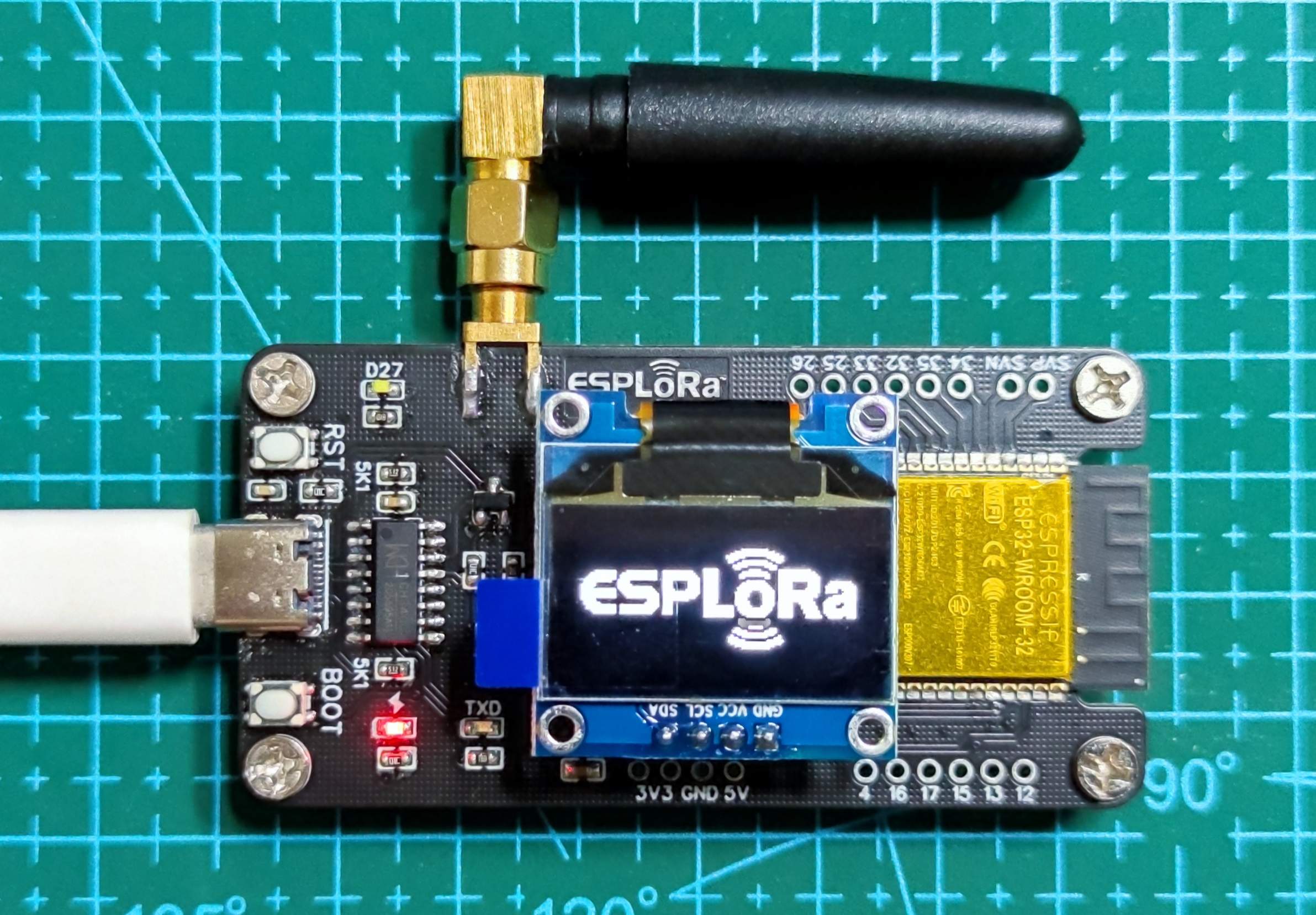

ESP32 LoRa Gateway
This project is modified based on the ESPLoRa single gateway for salt soda water.
It has been verified. The board verification was successful in early June, and it was not released until August, hahaha...
Differences from the original salt soda:
  1. Modify fuse F1 so that the fuse plays a protective role.
  2. Remove the Schottky diode D1 to prevent the circuit from not working properly due to insufficient USB input voltage.
  3. The capacitors before and after the LDO are changed to tantalum capacitors.
  4. The enable (reset) button of ESP32 adds a pull-up resistor and removes the BOOT button capacitor.
  5. Modify ESP32 packaging.
  6. LoRa antenna has new hollowing out.
  7. Increase the number of power supply pins.
  8. Add two WS2812.

Function:
  1. Developed with Arduino
  2. There is a self-restoring fuse ( necessary ), eliminating the trouble of replacing disposable fuses
  3. Reserve ESD device pads ( not necessary ) and use them as needed.
  4. The serial port chip uses CH340C, no crystal oscillator is needed, and it supports automatic download circuit. (CH340K can also be used, which is smaller in size. You can just change it according to your needs)
  5. Use a 4-pin OLED for display. Some OLEDs have different VCC and GND pin sequences. Modify them according to the OLED you have on hand.
  6. All available pins of ESP32 are pinned out.
  7. The capacitors and resistors are all packaged in 0603.

image display:
front
WROOM32S
reverse side
reverse side
Start interface
Take the mold according to the logo on the salt soda water PCB
start up
Test effect
