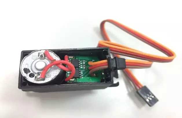

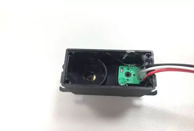

The interior of the brushed servo is divided into three major areas
  • control panel
  • brushed motor
  • position feedback sensor
Figure 2: Brush motor and control board
Figure 3 : Feedback position sensor

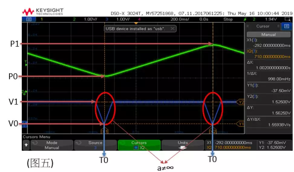

pictureFigure 4: Ideal rectangular trajectory motion ( red circle marks a =
V1 is constant speed
At this time, the red acceleration motion time is ideally zero
Green is the location track

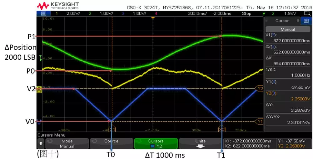

Figure 5: Non-ideal trajectory motion
It is necessary to consider that the process of the object itself from stationary → moving → stationary requires the so-called acceleration movement
CH2  Green : Position track (0~5) Voltage corresponds to (0~4095) LSB
CH3  blue : speed trajectory (0~5) Voltage corresponds to (0~4095) V

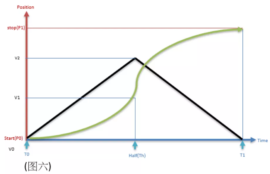

Triangular speed trajectory motion
As shown in Figure
V2 = (P1-P0)÷(Th-T0);
V2 = 2*V1;  Assumption : the motor speed can reach (2*V1)
Figure 7:  Actual trajectory movement time
Figure 8: Actual operation of the motor
CH1  yellow : PWM duty cycle (0~5) Voltage , corresponding to (0~100)% duty cycle

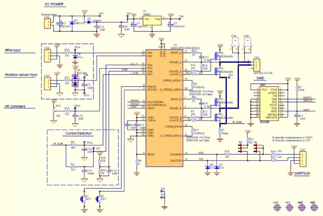

3. Hardware design
4 Conclusion
MM32SPIN motor/power supply dedicated chip has a built-in two-phase Gate Driver, which is very suitable for brush motor applications and greatly simplifies the design of the motor driver board. The built-in divider can also quickly respond to the trajectory control algorithm , improving software efficiency . It also brings the benefit of reduced development costs.
