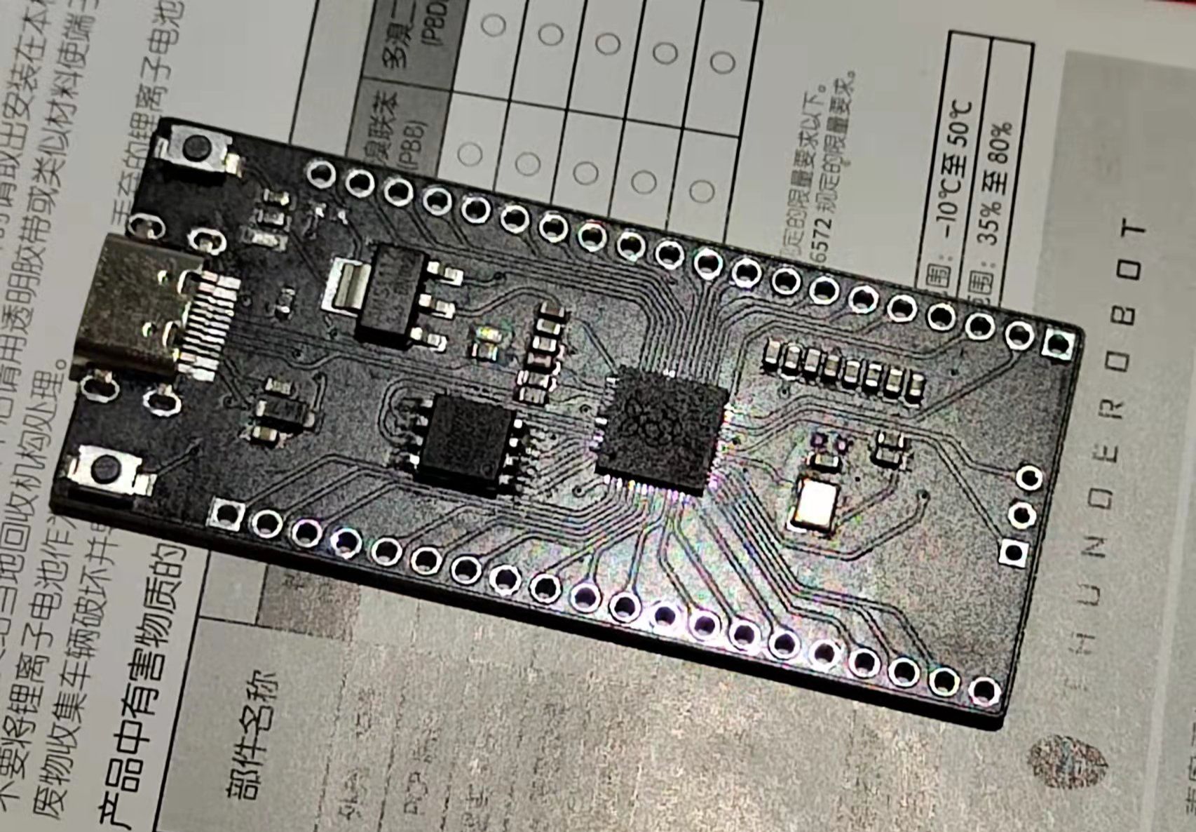

The reason why the Raspberry Pi RP2040
OK
failed to verify successfully was because there was too much tin in the gnd in the middle of the qfn, which pushed up the chip.
