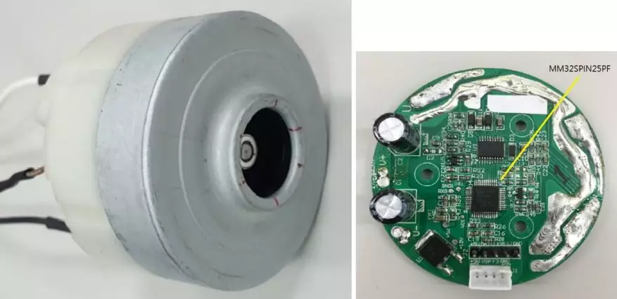

Figure 1.  Left : Common 25.2V/380W handheld vacuum cleaner motor
Right picture : Driver board using MM32SPIN25PF

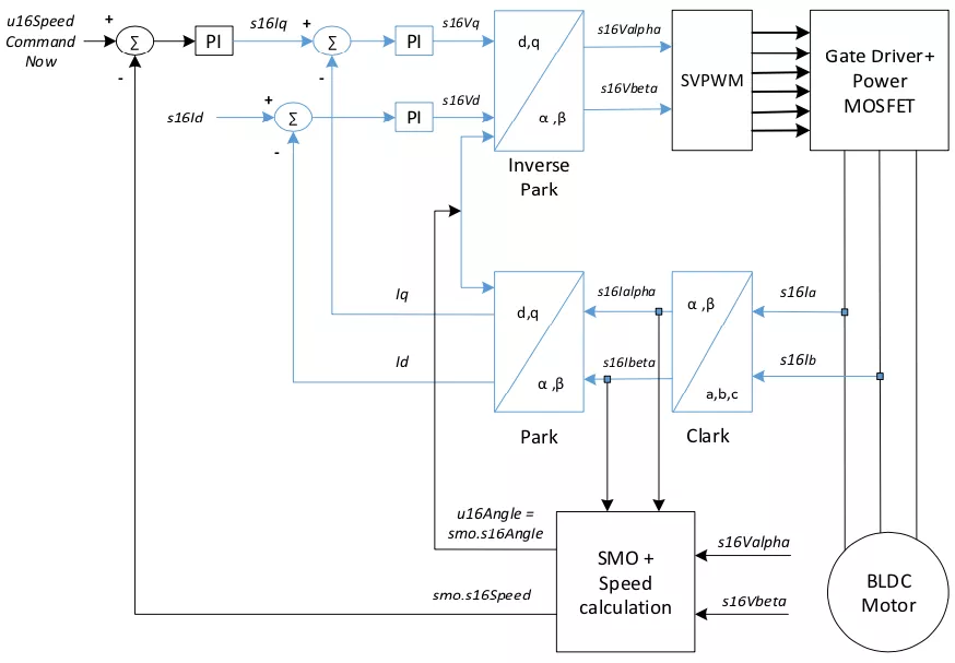

Figure 2 below is the control block diagram of the sinusoidal magnetic field guided drive motor. At the beginning of the process, the target speed command is read from the external input signal. After calculation by the closed-loop acceleration slope controller, the speed command that can be provided by the speed PI controller is obtained. Then, this speed command and the feedback actual speed are used through the PI controller. After calculation, the torque current command Iq is generated.
After the field-oriented controller (FOC) function block receives the torque current command and the estimated angle of the motor, it undergoes three-phase current feedback, coordinate conversion, current loop PI calculation, and space vector modulation (SVPWM) and other rule operations, as follows: This obtains the three-phase PWM duty cycle data required to approach the target speed, and then generates a PWM output from this data to an external electric drive component to drive the motor.
In the process of generating PWM signals by the magnetic field steering controller functional block, the sliding mode estimator (SMO) functional block is responsible for generating the estimated angle and speed required for motor operation.
Figure 2. Sensorless  sinusoidal magnetic field guidance ( FOC) software control block diagram

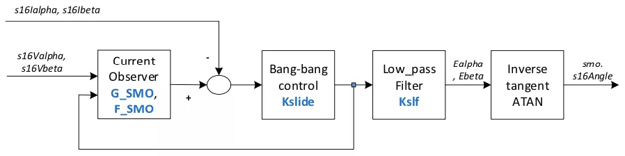

Figure 3 below is a detailed block diagram of the sliding mode angle estimation system. The sliding mode angle estimator consists of four main functional blocks. First, the estimated current is generated by the current estimator, and the difference between the estimated current and the measured actual currents Ialfa and Ibeta is used. After the bang-bang control and low-pass filtering function blocks are calculated, the estimated BEMF voltage value is generated. Ealfa, Ebeta, the estimated rotor angle can be obtained by calculating the arctangent of this estimated voltage value.
Figure 3. Sliding mode estimation (SMO) rotor  angle estimation software control block diagram

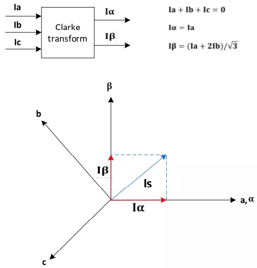

Clarke  coordinate conversion:
The purpose is to convert the three-axis (a, b, c) coordinate system of the three-phase current into a 2-axis coordinate system. The following formula is the Clarke coordinate conversion equation.
Figure 4. Clarke  coordinate transformation and its equations

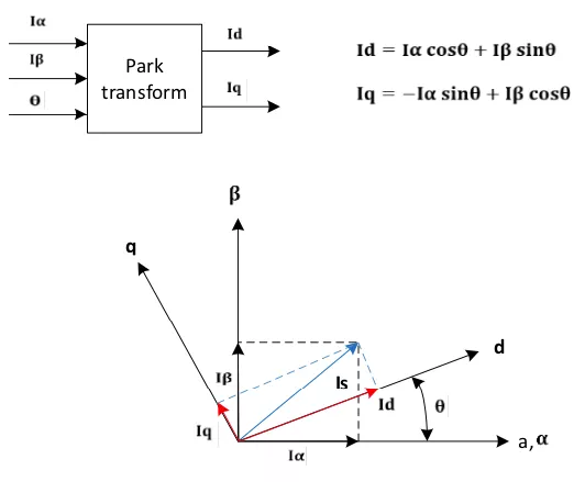

Park  coordinate conversion:
Convert the static 2-axis coordinate system into a 2-axis (d, q) coordinate system for synchronous rotation of the motor. The d-axis represents the direction and magnitude of the rotor flux current, and the q-axis represents the torque current. The following formula is the Park coordinate conversion equation.
Figure 5. Park  coordinate transformation and its equations

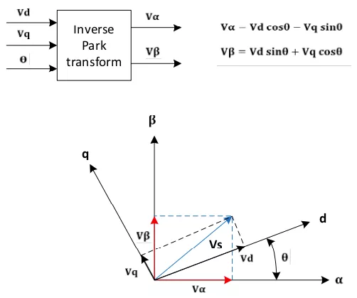

Inverse transformation Park  's coordinate transformation:
Convert the 2-axis (d, q) coordinate system of the motor's synchronous rotation back to the static 2-axis coordinate system. The following formula is the coordinate conversion equation of the inverse Park transformation.
Figure 6. Inverse Park  coordinate transformation and its equations

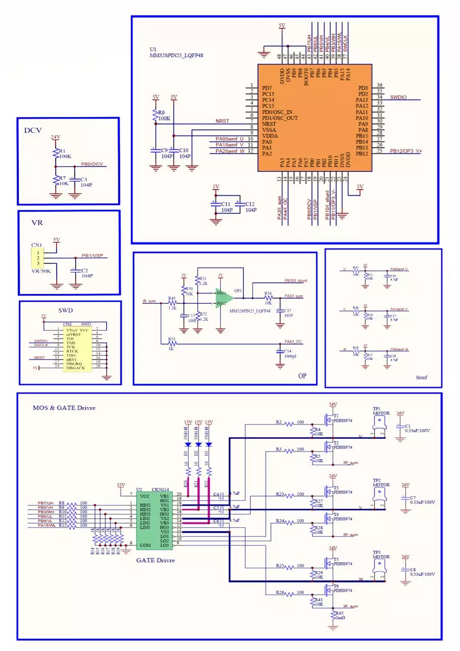

3.Hardware    design
The built-in comparator and operational amplifier of MM32SPIN25PF simplify the design of the motor driver board. The reference schematic diagram of the handheld vacuum cleaner motor driver board is as follows:
Figure 7. Handheld vacuum cleaner based on MM32SPIN25PF
Motor drive board schematic diagram

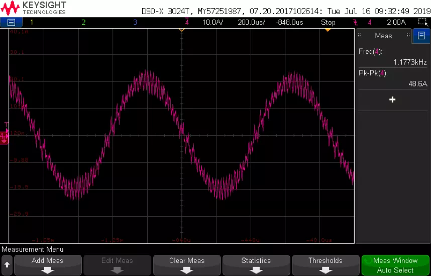

4. Phase current waveform driven by sinusoidal wave
This application case uses 180-degree sine wave drive. The phase current waveform under 300W operation is as follows:
Figure 8. Sinusoidal phase current waveform under 300W  operation

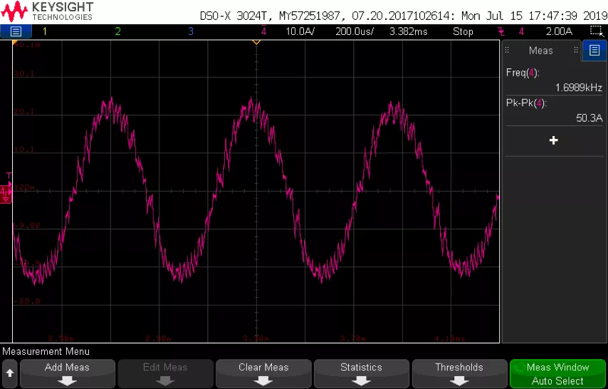

When the air inlet is blocked, the rotation speed can reach 100000rpm, and the sinusoidal phase current waveform is as follows :
Figure 9. Phase current waveform when the air inlet is blocked
