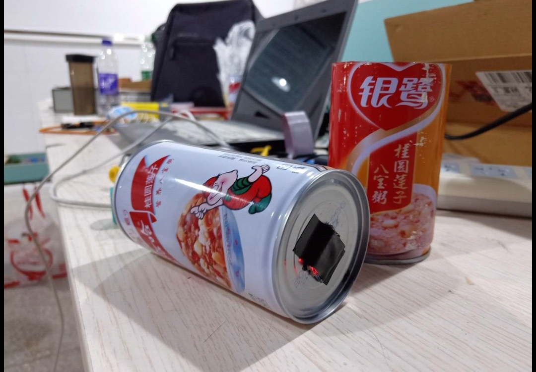

(1)Hardware and structure
The stm32f103rct6 microcontroller is used as the host computer, and the mpu6050 sensor and wireless transceiver module are externally connected.
The Zhengdian Atom Elite board is used as the lower computer to display measurement data, and the upper computer data is obtained through the wireless transceiver module.
The power supply is powered by four Nanfu batteries.
(2) Programming
Configure mpu6050 and wireless transceiver module.
Determine whether the rolling is tilted by measuring the z-axis acceleration of the gyroscope and determine the precise angle by looking up the table.
The rolling distance is determined by integrating the angular velocity of the rolling axis and multiplying by the circumference
The number of rotations is obtained by integrating the angular velocity of the rotation axis divided by 360 degrees.
The height measurement is based on the principle that the square of the speed is equal to 2gh. Since friction is not considered, a compensation coefficient is added to make the measurement value accurate enough, and then the optimal coefficient is obtained by adjusting parameters.
