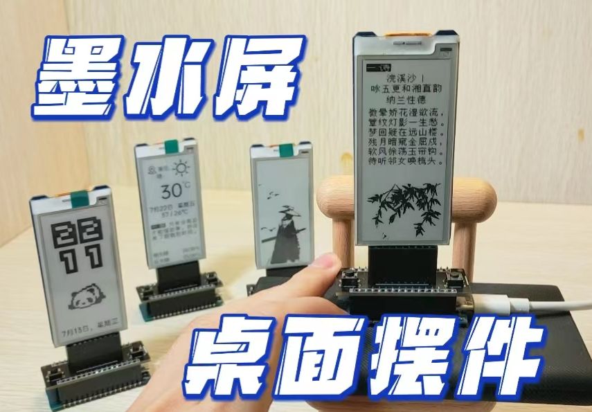

Hardware
1. Ink screen module
Ink screen module
It uses a 2.9-inch ink screen from Xianyu. The price of a single piece is around 15. The driver board was designed with reference to other ink screen open source projects.
In order to ensure proper plugging and unplugging effect, it is recommended that the PCB thickness is 1.2mm.
* Regarding the model of the ink screen, I bought two different models, one is Wei Feng and the other is HINK. The two are not compatible. Since the project uses the GxEPD2 library to drive the ink screen in terms of software, the solution is to use the GxEPD2 library. Just select the appropriate model. As follows:
GxEPD2_BW<GxEPD2_290, GxEPD2_290::HEIGHT> display(GxEPD2_290(/*CS=5*/ 7, /*DC=*/ 4, /*RST=*/ 5, /*BUSY=*/ 6)); // The second batch of screens
GxEPD2_BW<GxEPD2_290_T5, GxEPD2_290_T5::HEIGHT> display(GxEPD2_290_T5(/*CS=5*/ 7, /*DC=*/4, /*RST=*/5, /*BUSY=*/6) ); //First batch of screens
2. Base module
The base module mainly serves to connect the development board and the ink screen module ( the reason why I made this design is because it feels interesting and I want to try it hahaha). Weld the PCB socket to realize the insertion and removal of the ink screen module, weld the header to realize the connection with the ESP32C3 development board, and weld the buttons for display control.
*The keyword for PCB socket on Taobao is "NDK/TAT Noguchi bus socket PCB gold finger socket"
3.ESP32C3 development board
Use Hezhou's ESP32C3 development board. You can buy either the classic or simple version of the development board. I personally like the classic version, because when using the simple version, you need to pay attention to more technical details and it is easier to encounter pitfalls. Just solder the pin header upwards, because the pin header and female connector are connected, so it is very convenient to unplug it for other projects after this project is finished.
