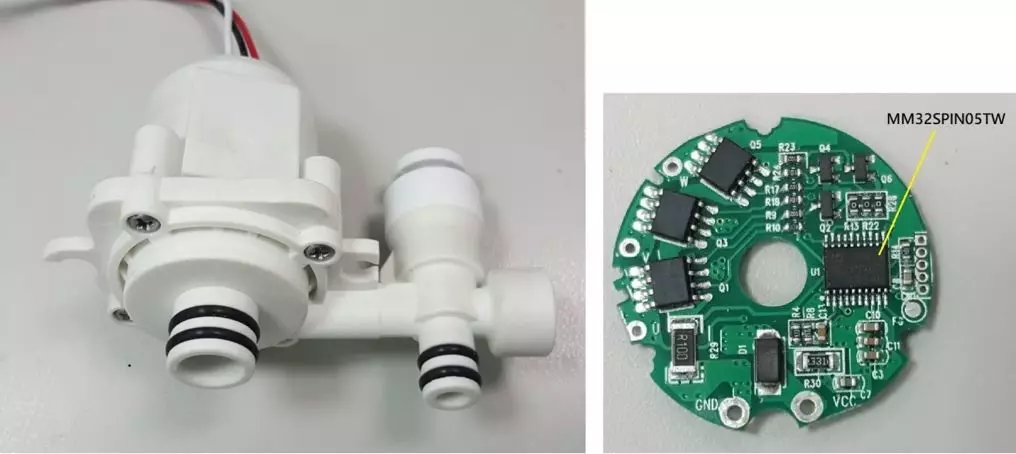

Figure 1.  Left : Common 24V/1 3 W small water pump;
Right picture : Driver board using MM32SPIN05TW

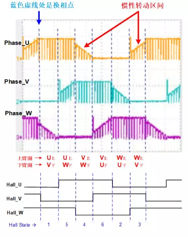

Correspondence between phase voltage and Hall signal
Square wave drive with sensor (Hall component), the MCU can obtain the position of the rotor through changes in the Hall signal for correct phase commutation. How to obtain the position of the rotor when there is no Hall component? Observe the square wave driving waveform with Hall component in the figure below. The commutation points are all located when the Hall state changes, as shown by the blue dotted line. At the same time, it can also be found that while the Hall state remains unchanged, there must be a The phase is "undriven" and rotates inertly and assumes dynamo status, as shown by the red indicator. This "undriven" period is extremely useful, and we will use its voltage changes to replace the function of the Hall component.
Figure 2. Correspondence between phase voltage and Hall signal

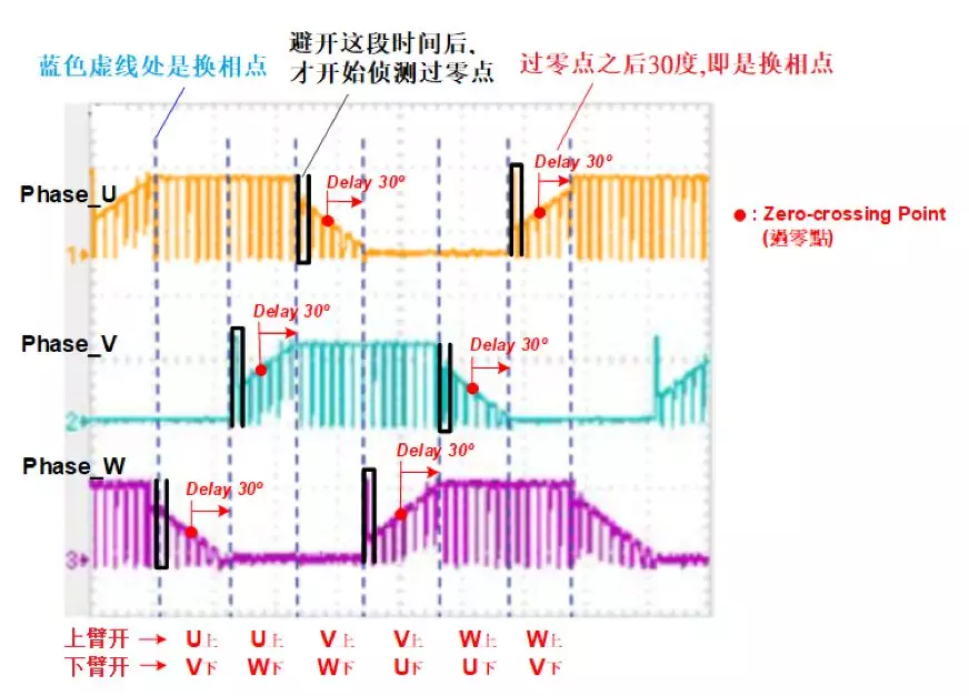

Zero-crossing detection replaces Hall signal
This section will teach you how to use the voltage change in this "undriven" inertial rotation area to replace the function of the Hall component. Please refer to the figure below. First, we define the "Zero-crossing Point", as shown in red The origin of the name "zero-crossing point" is that this point is located in the center of the "undriven" period of a certain phase. The phase current is 30 degrees before it (before commutation) and 30 degrees after it (after commutation). ) is the opposite direction. Therefore, if the position of this point can be detected, the next commutation point will be delayed by another 30 degrees, thus replacing the function of the Hall component!
Observe the figure below again. The phase voltage at the zero-crossing point (when the PWM signal is High) is approximately 1/2 of the DC_bus. We can use the ADC sampling function of the MCU to perform this detection work. The details will be explained in the next section. Implementation method. Note: The concave or convex phase voltage changes in the U-shaped black box in the figure below are caused by the current changes at the commutation moment acting on the windings of the motor (V=L*di/dt). It must be Zero-crossing detection can be performed only after avoiding it.
Figure 3. Zero-crossing detection replaces Hall signal

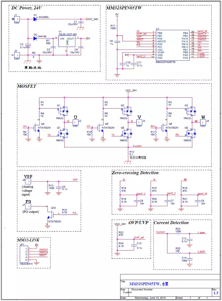

3.Hardware      design
The reference schematic diagram of the motor driver board based on the sensorless square wave drive for " small water pump " based on MM32SPIN05TW is as follows:
Figure 5. Small and medium power water pump based on MM32SPIN05
Motor drive board schematic diagram

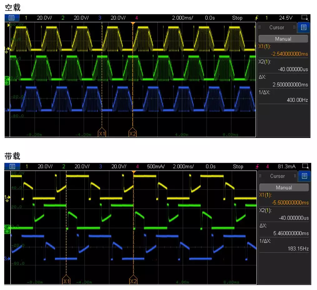

4.Voltage waveform
This application case uses a 120-degree square wave drive. The phase voltage waveforms at no-load and with load are as follows: ( the speed is 12000rpm and 5500rpm respectively)
Figure 6.  Phase voltage waveforms at no-load and loaded conditions
