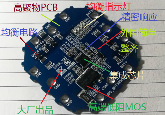

[To be tested] PCB4 string lithium band balancing solution controlled by IP3255
Module purpose:
Protects 4-string lithium polymer and 18650 lithium battery packs from charging and discharging overvoltage and overcurrent protection, providing balancing function
Module parameters:
  • Overshoot threshold: 4.25V
  • Over-discharge threshold: 2.7V
  • Balanced current: 50MA
  • Overcharge voltage delay: 1S
  • Over-discharge voltage delay: 0.1S
  • Short circuit protection delay: 200 microseconds
  • Charging overcurrent delay: 10MS
  • Over-discharge current level one delay: 10MS
  • Over-discharge current secondary delay: 1MS
  • A 33 milliohm current sensing resistor is installed by default, corresponding to a continuous current of about 6A.
Adjustable balance current, adjustable overcurrent capability, low internal resistance MOS
Update log:
【2020-8-26】The board has arrived and is being tested. There is still a key balancing resistor missing. I estimate that we should be able to give an approximate figure this week.
