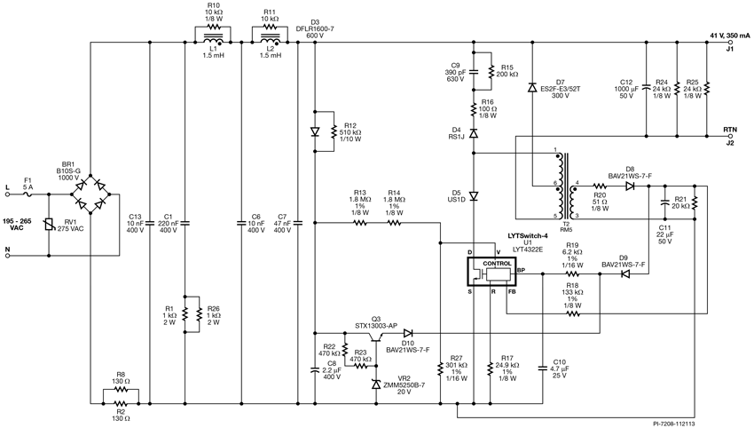

DER-395 - 14.35 W high efficiency (>86%) high power factor (>0.95) TRIAC dimmable non-isolated LED driver
DER-395 - 14.35 W High Efficiency (>86%) High Power Factor (>0.95) TRIAC Dimmable Non-Isolated LED Driver
Summary and Features
-Combined single-stage power factor correction and constant current (CC) output
- Efficiency >86% at 230 VAC
-TRIAC dimmable
  - Works with a wide range of TRIAC dimmers
- Low-cost, low component count, small size PCB
- Fast start-up time (<200 ms) – no perceptible delay
- Integrated protection and reliability features
  - Output short-circuit protected with auto-recovery
  - Auto-recovering thermal shutdown with large hysteresis
  - No damage during brown-out conditions
  - Line overvoltage protection
- PF >0.95 at 230 VAC
- Meets EN55015 conducted EMI
