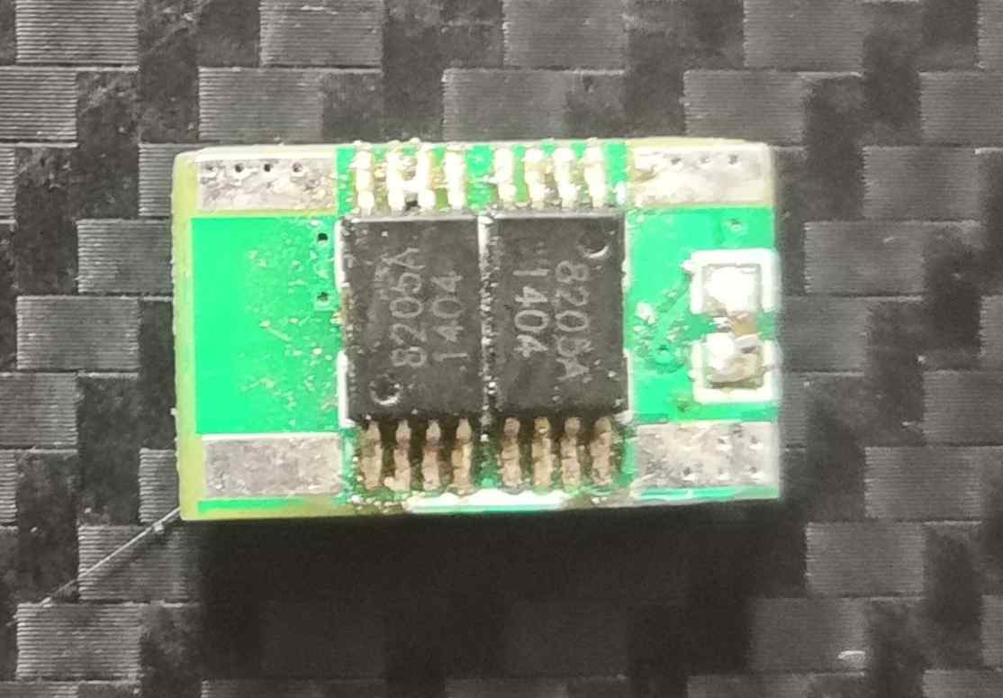

Super small Loli one-way ESC PCB with brush
  1. The PCB is only drawn based on the Loli one-way ESC tutorial. The firmware is not developed by me. It is adapted to the Loli brushed one-way ESC (new version of the program).
  2. Small size, only 12.8
  3. It has been tested on the board and there is no problem. It works normally.
  4. The ESC does not have a BEC output and needs to be connected to a 5-3.3V power supply. It can also work with 1S voltage. It is recommended to use a 5V microcontroller STC15W104-SOP8 resistor 1K-0603 resistor 10K-0603 FET 8205*2LED-0603. There is a socket in the BOOM, but it does not actually work. Needed, just to take advantage of his pads
参考设计图片
